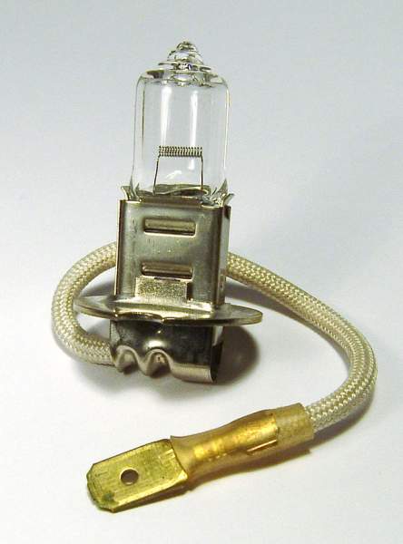

Andrew, Hi, Thanks, the H3 I've got looks like this, the flying lead is for the power supply , or so I am lead to believe. So if that's the case, where is the Earth
Rich
The body of the bulb touching the headlamp holder is the earth, but you will need to make a short wire tail from the body to the holder plate to earth it.
Yup; Graham is right - assuming you have a J-spec car; because the body of the bulb-holder will not otherwise be earthed unless you do the above modification.
Okey Dokey, Thanks guys, appreciate the advice, '

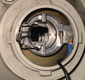

This picture shows the black earth lead connected to the H3 bulb mounting baseplate, the other end of which
goes to the low beam harness ground connection. The flying lead on the H3 bulb goes to the +12v supply low
beam harness connection.
Thanks guys all good information, gratefully received, Andrew, great pic, just what I needed, seems you're helping me a lot lately
