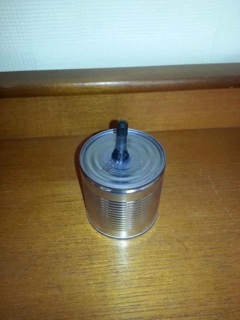

easy to make a DIY one if in a hurry, put a how to up few years back think it was a tesco chocolate drink lid was the right size drill a hole in the middle and push a car tyre valve through hole works a treat.
