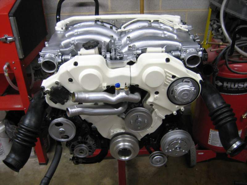

He wasn't overloaded with tech speak. Every acronym was explained (CAS, DTC etc) and I even supplied a picture of an engine. My posts later were tongue in cheek, at the end of the day, until DTCs are relayed on here, it's all a bit moot.
