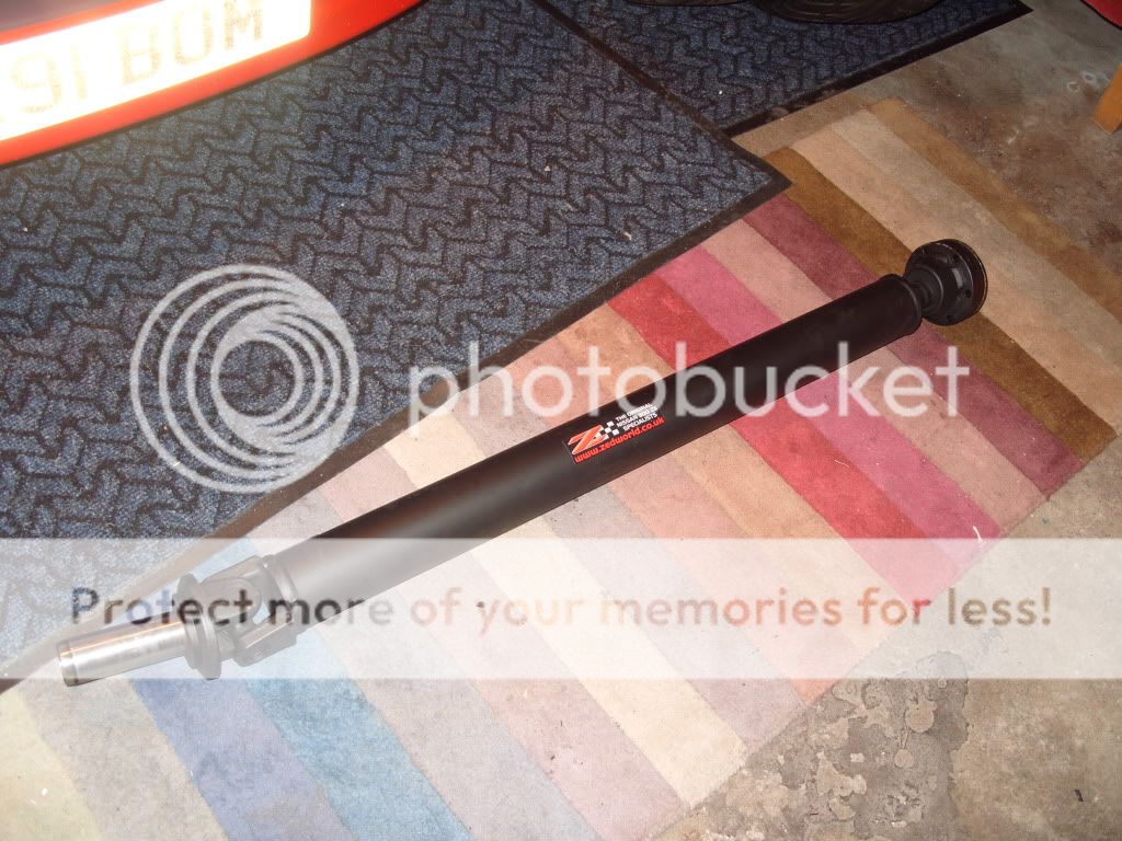

Thanks for that Stephen, I had a 27 inch shaft at home, had to beat it in with a hammer and was to long, hope I didn't damage anything.. @gary that looks the buisness Garry and every one seems to like the 1 piece shafts jeff makes up, the cost getting it posted to ireland is the only problem. Have you any idea of the exact length of prop shaft?

There is a big difference, the car feels more responsive.
the Propshafts are approx 4>7kg lighter than stock
£255inc VAT Delivered 12 months warranted
