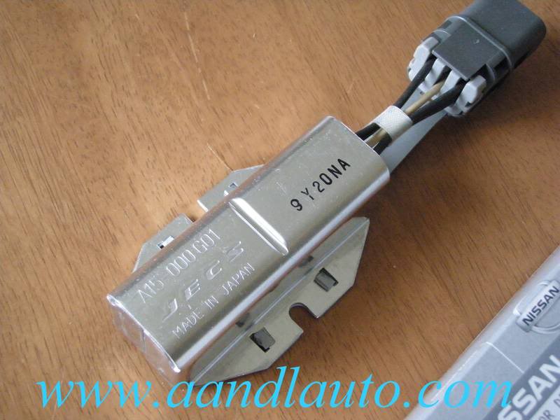

is the PTU refered to as a resistor pack?
Now my car is not starting at all i went through all the old service history and found the same problem occurring,a temporary repair was done on the fuse board of the resistor pack some years ago and fixed the non starting problem.
i am wondering if the resistor pack is the PTU?I have just bought a series 2 PTU and harness and waiting for it to arrive (if it isn't this it is something i have been meaning to get)Any ideas would be great
1990 Auto tt import
The PTU does indeed contain a set of resistors and could be referred to as that, if you are getting no spark, then the PTU is the likely fault and if there was a known problem in the past with it, then replacing the PTU is a wise move, if not to eliminate that part of the system as the issue.
Many thanks would explain a lot of problems that seem to go back the last owner who had break downs and miss fire issues but never up graded just had a temporary repair hopefully the new ptu solves all the issues. I'll open the old one to see what kind of bodge was done inside.

Resistor packs (aka dropping resistors) are used with low-impedance injectors, in the Nissan world that applies to top feed injectors as fitted to the 200SX S13 CA18DET, Pulsar GTiR, Skyline RB26DETT etc.
There are some Nissan applications that use high-impedance top feed injectors as well (Skyline RB20DET).
The resister pack question because a previous invoice quoted they did I temporary repair on the resistor pack and I can only think it was the ptu without taking it apart to find out
