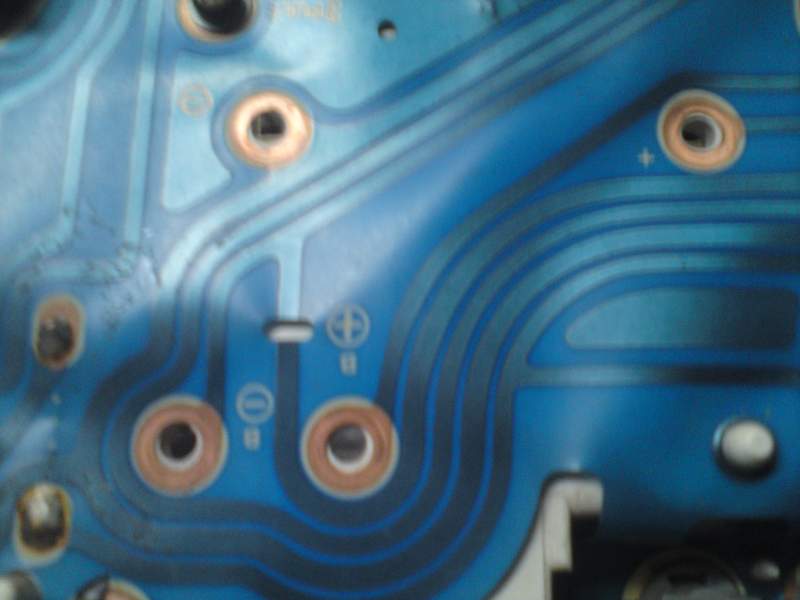

That only S4 boost gauge i've got is in the car but i refreshed my memory by looking at my other 2 spare clock which are in bits, it only connects by bolting with the 3 bolts to the flexible pcb, nothing else is required, except of course for a boost solenoid which connects near the bulk head and the plug will be there somewhere for it.

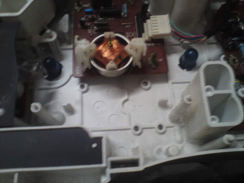

Does the S4 cluster have the 3 bolt holes for the boost gauge regardless of whether one is fitted? Because the S1 gauge is also held on by 3 bolts through the pcb so I may be able to fit it. If you have a pic of the back of an S4 cluster could you upload it? I have a pic of the S1 so I can compare. If I can work out how I'll upload it here!
I must apologize as there are 4 holes for the boost assembly not 3, a further one a little away from the triangle 3, two are marked B+ and B- with the other two just positive and negative, B of course is for boost as there is a T for temp and F for fuel on the pcb sheet !!
Not having a boost gauge on the bench i cannot offer in and see if all these 4 points are used/required for sure as opposed to just being bolt down points.

Thanks that's just what I was looking for! Unfortunately my S1 cluster has 4 bolts in a diamond shape (there seem to be blanks for these in the white plastic on yours) so not sure if it'll fit with the PCB connections on the S4. I was hoping to get the importers to swap the gauge in while doing the UK conversion work but it looks like it might be better to wait till I have both clusters on my own bench. It's clearly not the simple plug n play I was expecting!!

I now have a picture of the back of the S4 cluster and it's exactly like the blue one you posted. So there are pub tracks and bolt holes for a boost gauge even though one isn't fitted. But it's totally different to my S1 cluster. So it looks like I'll have to start searching for an S4 boost gauge or a cluster with one. This could take some time!

Just for reference, in case it helps anybody else in a similar position, I finally pulled my finger out and managed to get a photo of the backs of the two clusters uploaded...
Z32?authkey=Gv1sRgCOT6sNaDnL6FjQE#6081581041572126482
The green one's from an S1 (with boost gauge), the blue ones's from the S4 (with no boost gauge, but with all the connections for one)

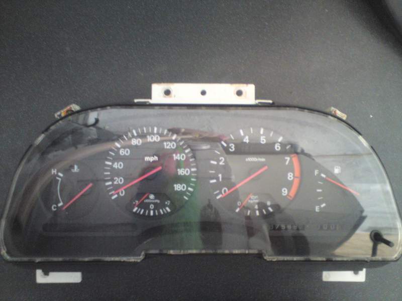

I couldn't believe my eyes about 10 days ago when i saw some S4 clocks on UKebay with the boost gauge, i double checked, kept rubbing my eyes and i struck a deal with the seller and they duly promptly arrived.
So they do appear from time to time :yes:. The front lens wasn't great but luckily i had a vgc one and this took only minutes to fit, i also put some fuel in :devil2:.
Not for sale let me make that clear as they're a great stock untouched spare for mine, the ones i have fitted in the car have the boost gauge of course with bespoke made indiglo dials - to my annoyance my low fuel light doesn't work and i have tried and tried to get it working but to no avail, so one job at some point would be fit the new acquisition you see pictured and see if the low fuel does come on.
