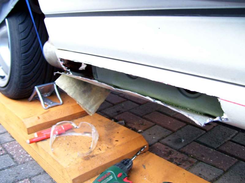

I bought some old reclaimed 10x2" scaffold planks for around £30. I staggered them up, to provide enough clearance for the bumper, 5 tiers, giving me a total of 10" lift. I chamfered the front of each tier to assist driving up.
Cheap, quick, easy and most importantly, safe. The only downside is that they're big and heavy to store/manoeuvre.
