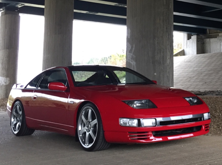

Keith runs 9.5 all round coz he bought my 9.5 cruise alloys off me and put them on the front. Gunmetal grey they look the dogs too

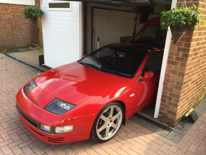

Ive 9.5 all around,255 rear 235 front slightly stretched, no problems- drives great.ImageUploadedByTapatalk1415298336.048154.jpg
Anyone got any thoughts on whether a 9.5" front wheel with ET35 would sit too far out of the arch...?
I have 235 tyres on 9.5 et35. Next set of rubber, I will try 245 as there is a bit of stretch which I dont like, but at the moment mine runs fine without any issues, but I still think it could do with an extra 10mm to get it flush where I would be happy
