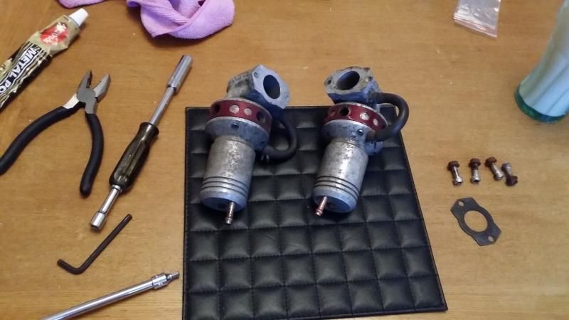

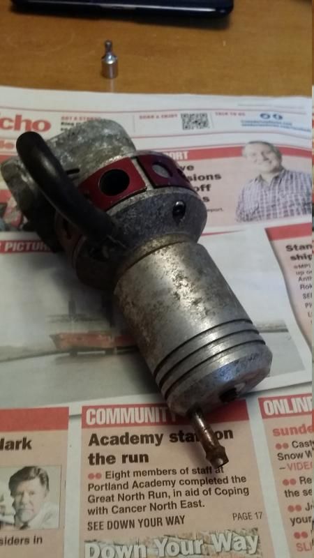

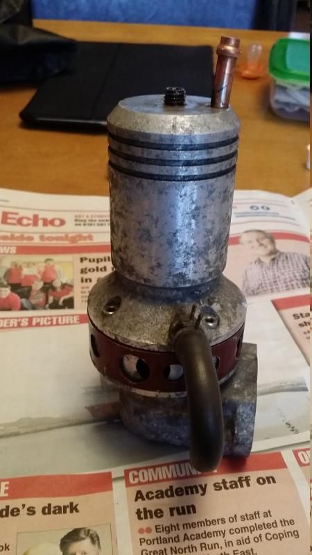

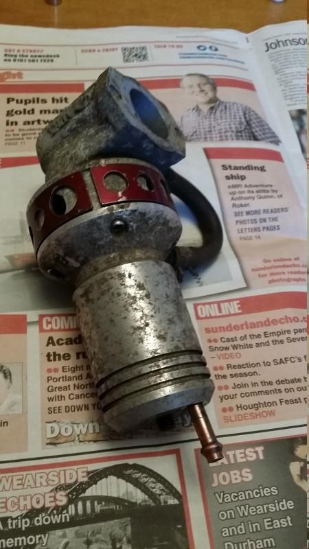

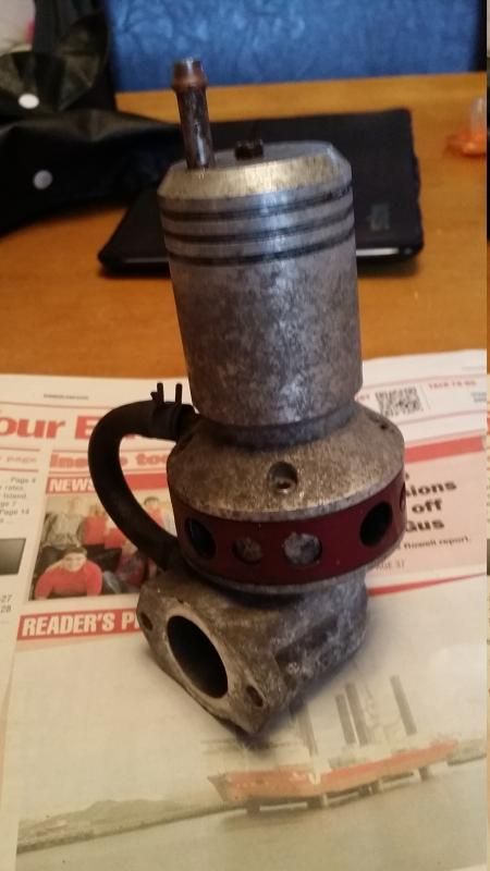

Right, I've took the BOV's off the car and they're minging so I shall give them a clean. Anyone know how I can move the stupid adjusting screw as they a corroded and the Allen keys just turn when I apply too much pressure.
Here's some pictures just for the crack
Starting to clean them
