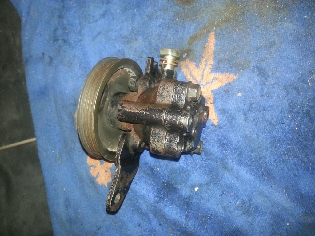

how to convert tt steering pump to na
If you have hicas lock out bar and don't want to waste money on na pump you can make one from tt pump

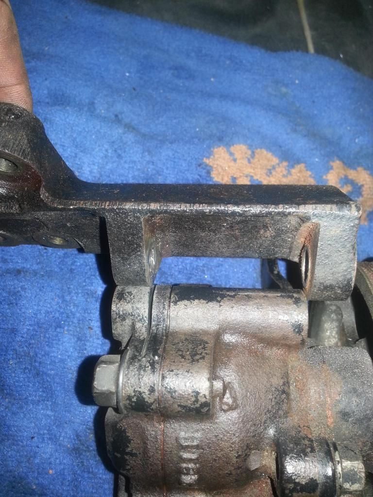

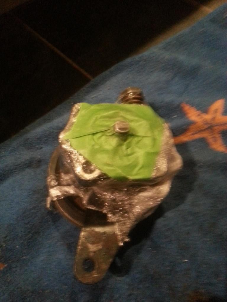

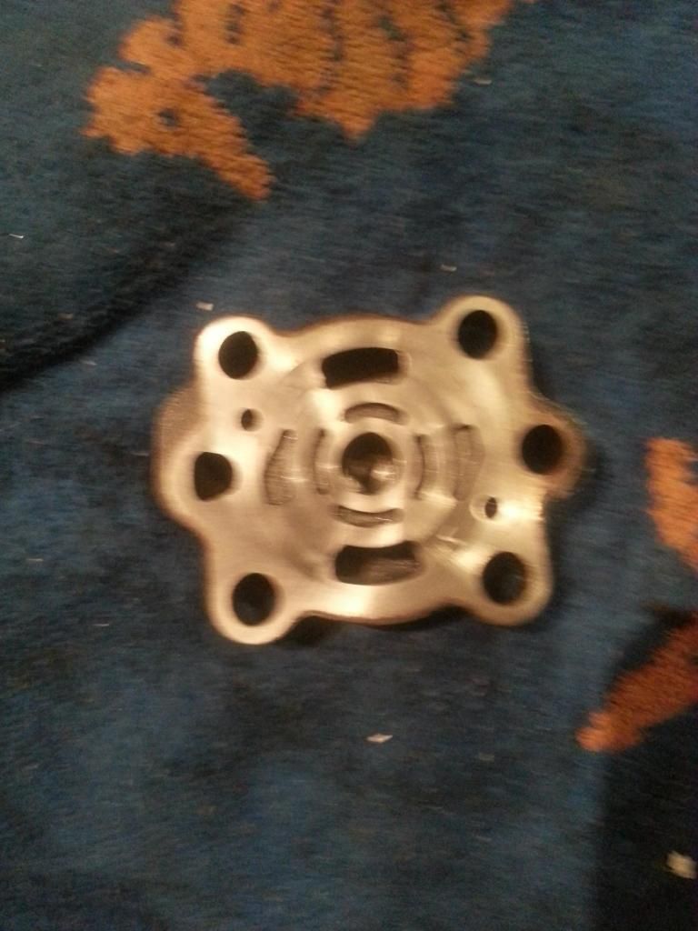

Take off the back plate. Remove middle chamber and cut the shaft
Drill a bit large hole in the back plate to fit the shaft
Reasemble the pump
And cut the back plate so it does fit the bracket

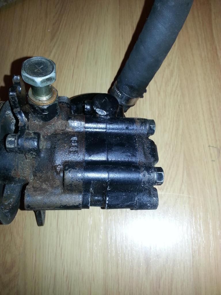

So you will just have a random flange blanked off in the breeze?
What do you mean ?
The resivoir connection, the thick tube from the pas pot to the pump, on a Ty its got two take offs, one for ech section. You've deleted a section, this leaves areduntant feed. It's like an upsidedown y shape.
Rather removing the pump just remove the feed pipe to the hicas and fit on to the return on the reservoir, work just as well and you will have time for a cup of tea as well.....nice.
