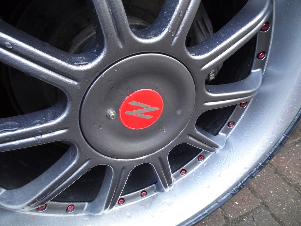

Honestly they look awful, feel bad for you mate.
I am sure you have a few options here, first would be to at least mention trading standards.
I understand this is frustrating for both parties here, you obviously and I'm sure he isn't happy doing a job a third time. However at the end of the day you deserve what you payed for.
I have quite a bit of experience of powder coating from an industrial point of view and I can say without a doubt that the finish wouldn't pass for even agricultural equipment. Honestly the guy should be ashamed.
If it helps you should have my deposit.
That is cheap £250 for all that work, what's he saying if you paid the going rate he'd of done them better.
It looks like rattle can work..............one very thick coat.
I got my mercs wheels powder coated in silver sparkle, i removed the tyres and got rid of the kerbing marks and the charge was £60 a corner, i was very happy, the finish is perfection, flat, smooth and shiny - better than merc ever did them.
They shouldn't be like that Simon at all, it's poor work and one he obviously regrets taking on sadly.

If you have experience in powdercoating, can you tell me whether the surface should be heated before the powder's applied, then heated again to cure it...?

Name and Shame, I'm with Joel on this one, it's thought that the heat process of powdercoating can deteriorate the wheels integrity and cause them to get brittle. You've had them done twice now, I wouldn't be going that route a third time as the wheels will most probably break up if you hit a pothole etc., that was one of the theories surrounding the late Great Joey Dunlop's death, that his newly powdercoated wheels shattered causing his fatal crash. I'd get my money back and put it towards a set of new wheels to be honest. Not what you want to hear I know, but at least it would give you peace of mind.
He's now stopped replying to my messages so his final word (thus far) is that I can either pay him to have them done again, but in a single colour... or I can just live with them.
So there's no initial option of a refund, or even a partial refund, as he's made it blatantly clear that my job's already cost him more than he bargained for. He showed that by trying to get an extra £75 out of me which, ironically, would still have left me with this finish anyway!
I honestly think that the hammered effect to the finish is down to the primer (powdercoated) not curing uniformly and so leaving a lumpy surface. He's said that they really needed flatting completely by hand, but that apparently wasn't an option as it would eat too much time for him... WTF....
All in all, I find myself rather unhappy and disappointed today. I'd hoped that the refurbed wheels would pretty much finish the exterior off but, instead, they just ruin the whole look of the car now.
The guy's approach to "happy customers" is somewhat grating, to say the least...

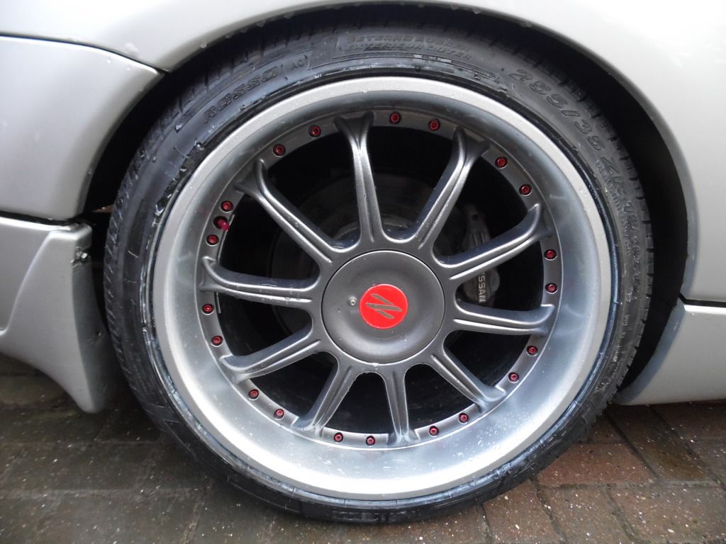

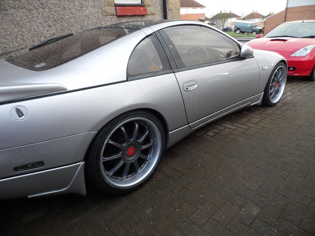

Looks so much better with the centre caps and bolts, just don't let anyone get within a meter of them I guess[emoji14]
Edited by Alic
That's the rule for the time being: don't look too closely! :lol:
Generally speaking (I've dealt with massive automated machines) the most important part is getting the clean and remove all the old paint etc. Generally speaking powder coat is very forgiving and goes on very thick.
They shouldn't need pre heating, if he isn't using an electrostatic charge then this will cause poor distribution (not enough and it won't flow, too much and you get sagging/runs etc)
The temp and baking time will also be a big factor, too short/cold and the plastic will not smooth out.
Sound to me like he has skipped on the prep work and doesn't really know what he is doing, the same goes on his business practices.

They do look much better with the centres and caps on them.

If Si is going to small claims at this point, I would send the pictures to a reputable powder-coater to see his opinion.
Ask if the job is satisfactory for £250 and if the method he used was correct (i.e whether he electrostatically charged them or not), then you have a source that you can support your argument with.
Just seen the pics Si, absolutely gutted for you, why don't you see if Keith (KJZ32) can paint them up for you, didn't he do his wheels recently??

I quite like them, to be honest. They're not ideal, no... but I think they suit it. Or at least they did...! :(
