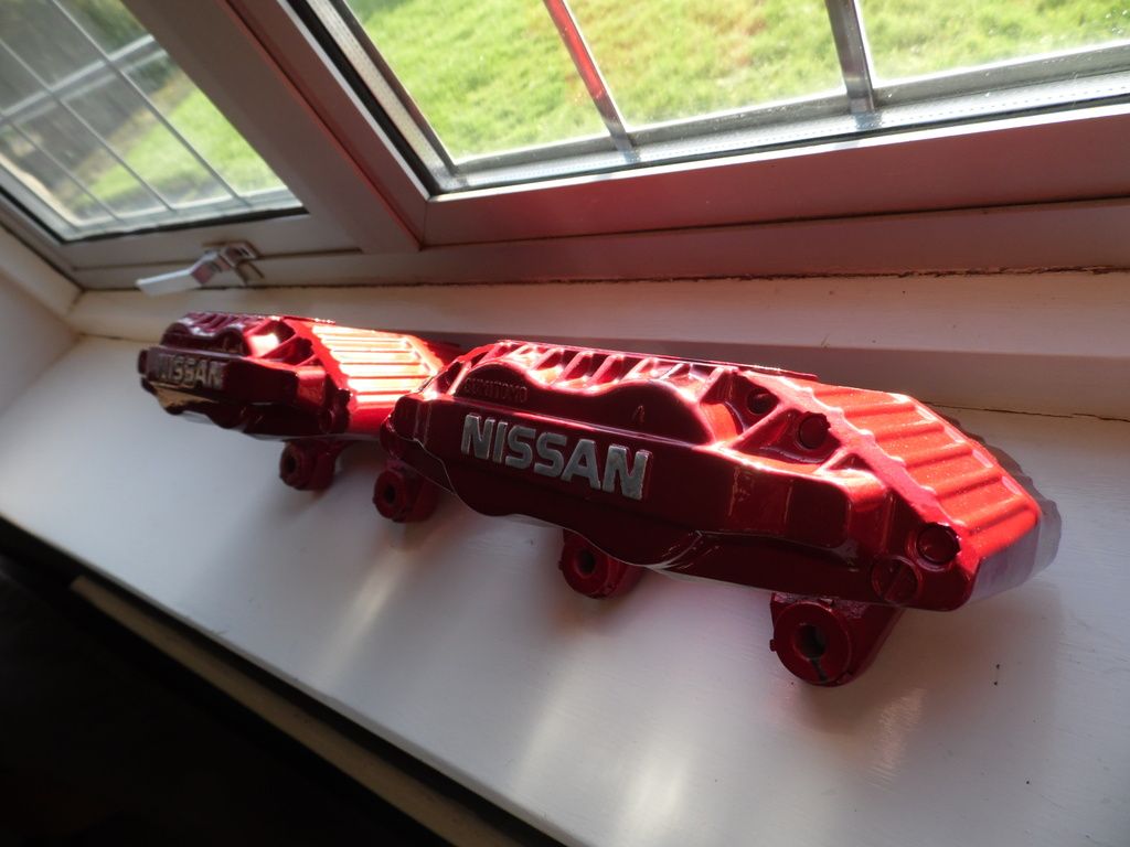

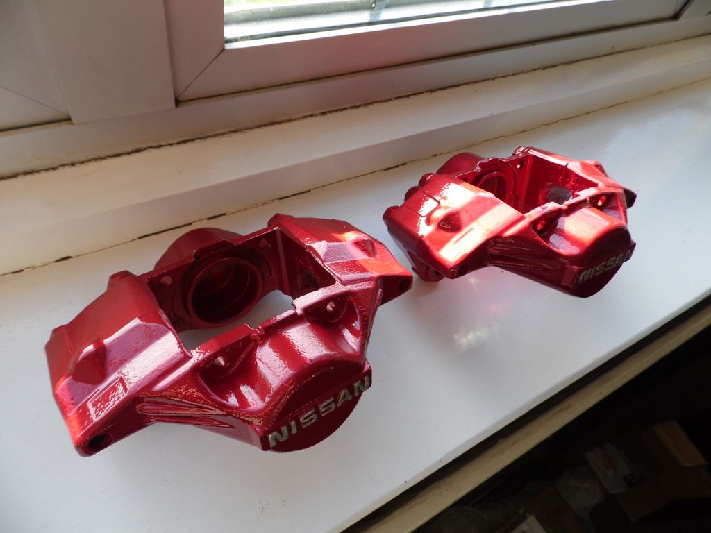

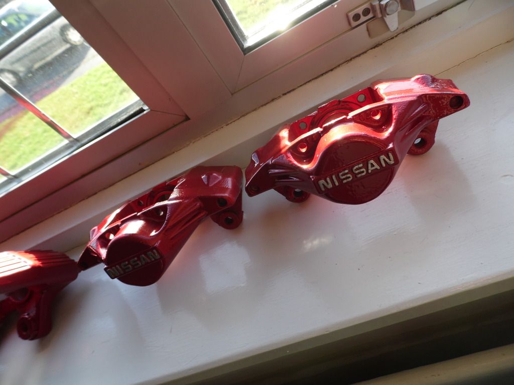

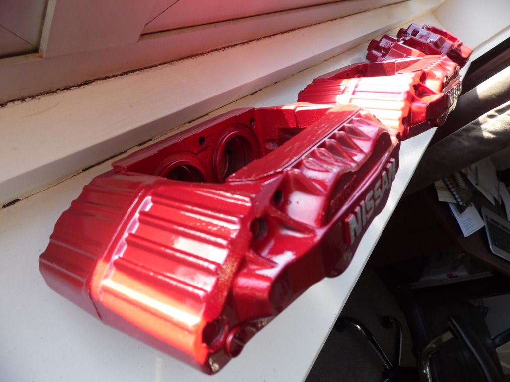

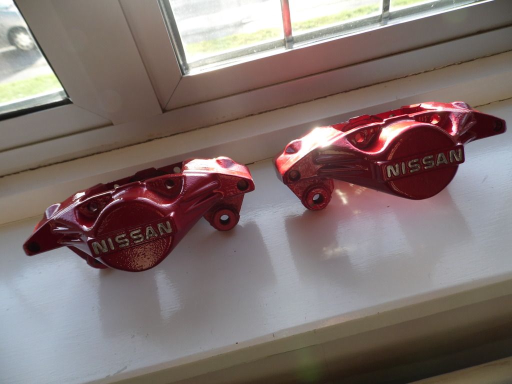

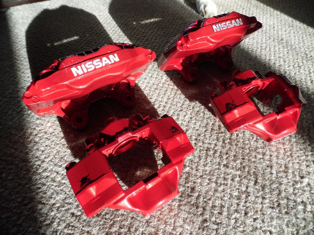

Calipers collected :)
When I'd dropped them off, I started having a few doubts over the colour choice but, now they're finished and back here, I've decided that I made the right call:
Candy red!! :biggrin:
My reasoning for this is as follows: my Zed is very silver! Silver body, silver wheels... I wanted a splash of colour on the exterior that wasn't going to be too vulgar or garish, and that would tie in nicely with the "silver & red" them that seems to have evolved.
I didn't want plain gloss red and then I thought "Candy, to match my engine!" So I umm'ed and ahh'ed and then decided to take the plunge. Seeing as there's not a huge amount of caliper visible behind my many spokes, this should provide the splash of colour I wanted without being too OTT. :)
The pictures make them look far less shimmery than they are in real life. The calipers themselves have been wire-wheeled and soda-blasted prior to painting, and there are brand new pistons, seals and clips to be installed. Once these are fitted, along with the stainless steel lines, I should find that my brakes are absolutely tip-top! :biggrin:
Happy Mondo this morning :thumbup:

Thanks, Gaz :)
Like I said, a splash of colour partially hidden behind my wheels will look pretty nice... and the candy coating darkens the red down somewhat too, which was what I wanted.
Looking forward to finding a few spare moments to get them rebuilt and then get down to Mr Dent's gaff and have them and various other bits fitted! :biggrin:

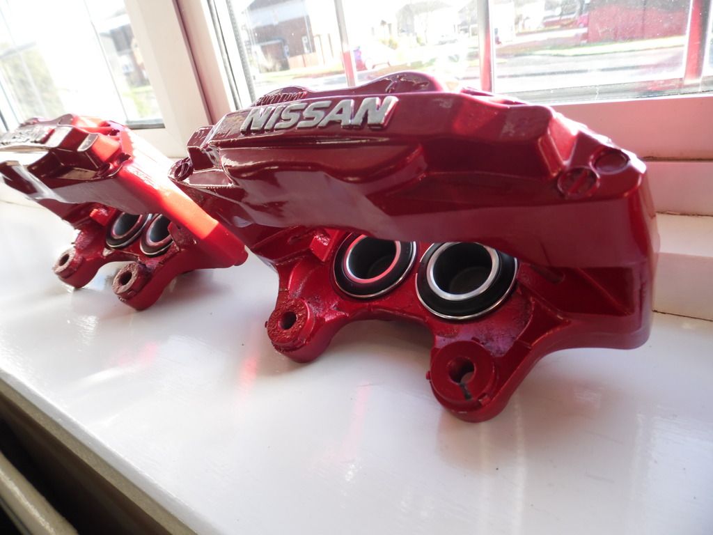

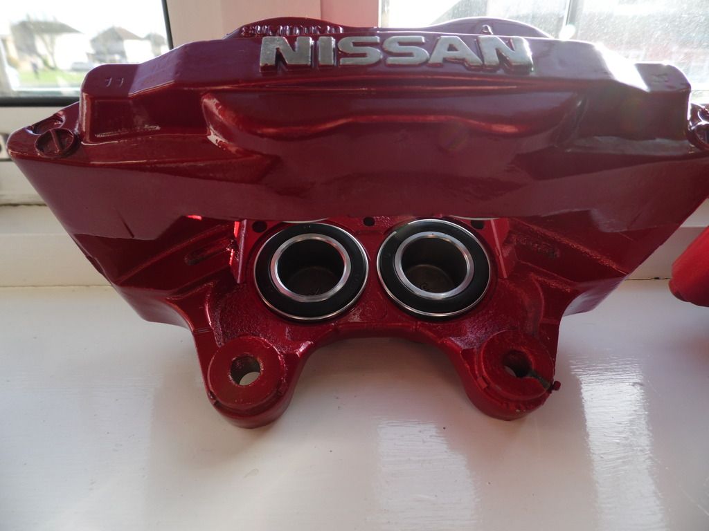

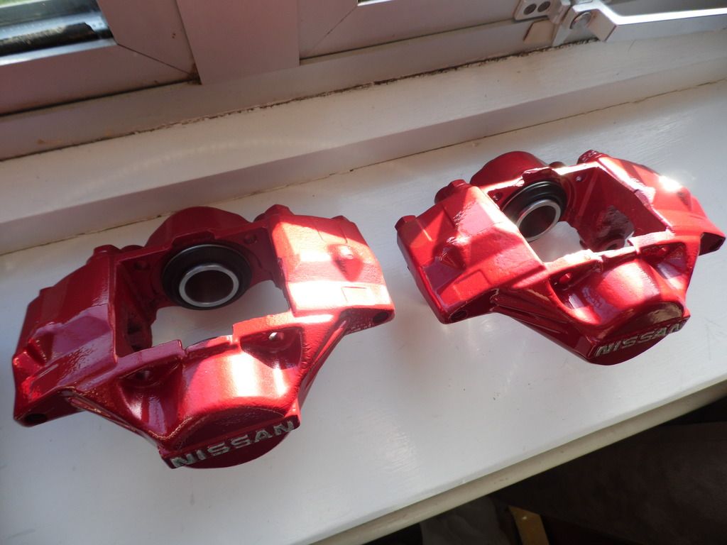

Fully rebuilt now :) :
Very nicely finished Simon! Another way to finish the logos is to use a flat file to remove paint on the top surface of letters and
get a "machined" look.
Or something like 240 paper on a block, putting the white back with an artists brush shouldn't be an issue but consider lacquering over it after for longevity, nothing wrong with the red btw......good choice :biggrin:.

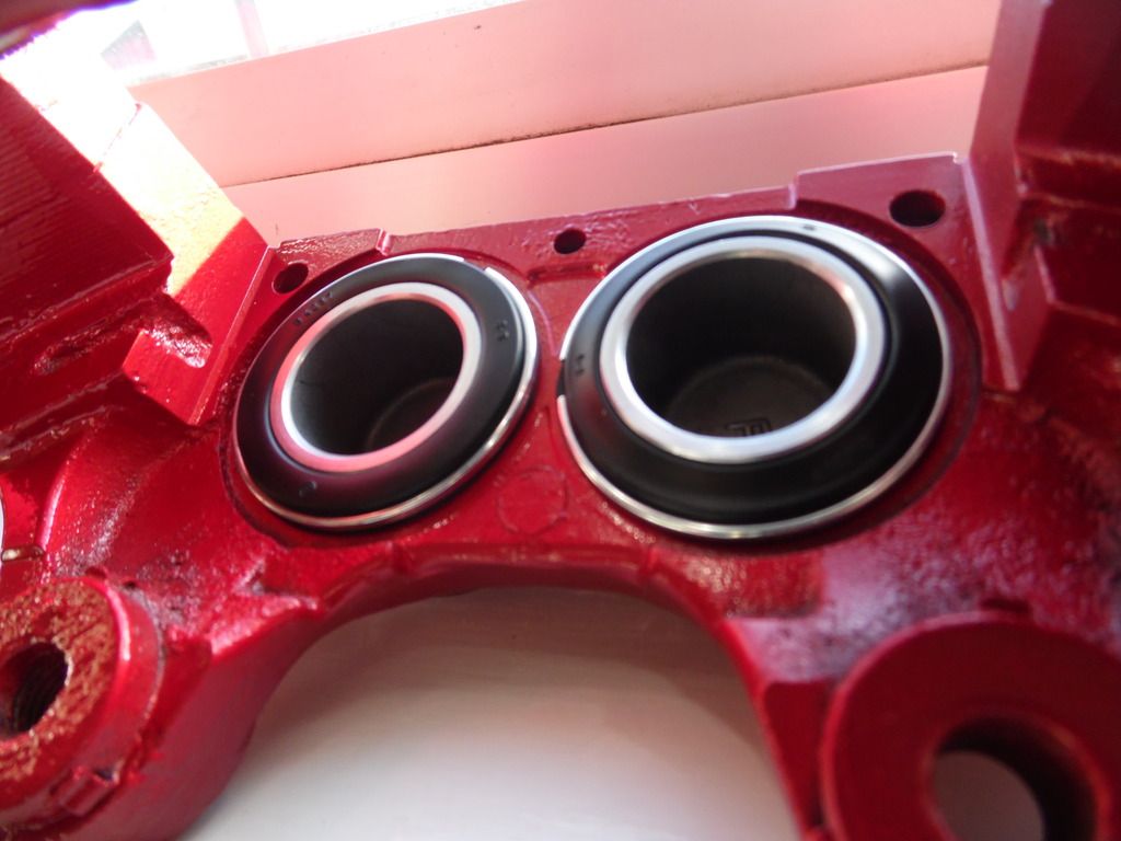

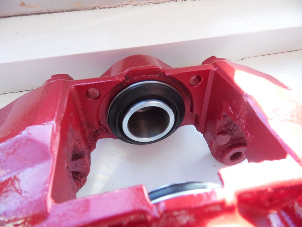

I have a bit of a concern about these newly rebuilt calipers...
On the rear ones, where the dustboot sits on the caliper, there is a small lip so that, when the retaining clip is in place, it locks in under this lip and so secures the boot firmly into place. :)
On the fronts though, there is no lip! So the dustboot and it's retaining clip just sit against the caliper, as opposed to being locked into it.
I can only hope that, once the pads and everything are refitted, the dustboot won't flex sufficiently to unseat itself from where it's mounted...!
