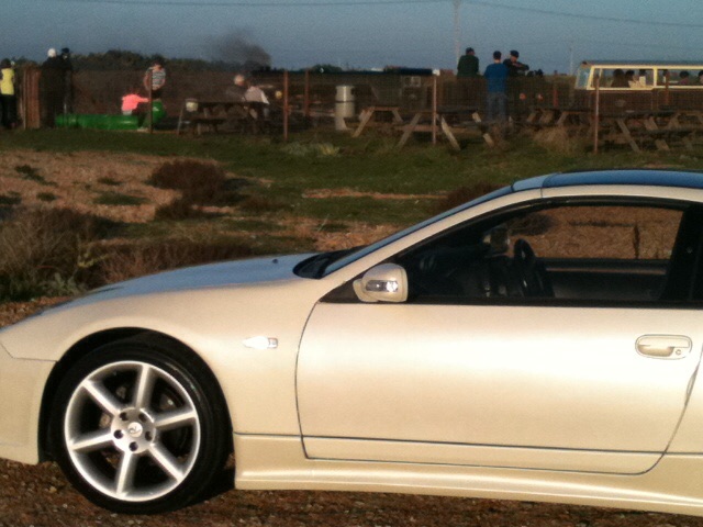

Mines Pearl!:yes:
[ATTACH=CONFIG]83584[/ATTACH]
[ATTACH=CONFIG]83585[/ATTACH]
[ATTACH=CONFIG]83586[/ATTACH]
In Seabrook , & Dungerness!:dance:
Any excuse to post pics of your car. Still waiting to see mine in the daylight as I had to leave after finishing spraying it
