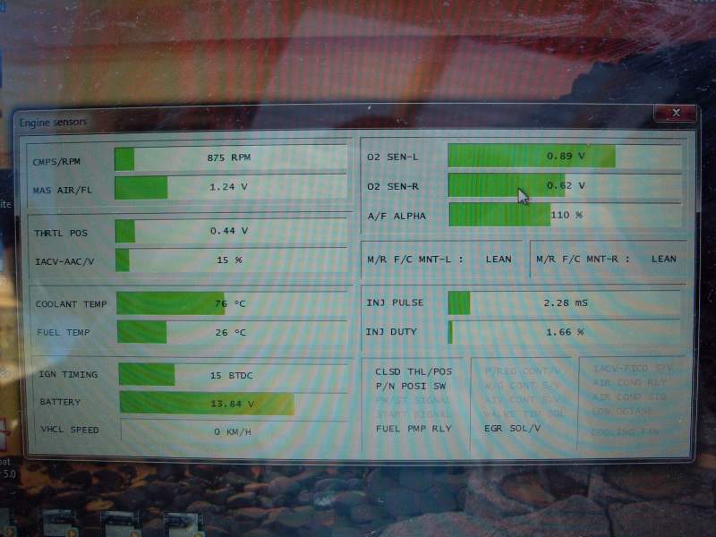

here is mine looks the same as you on conzult I have removed my IACV THO SDC12583.jpg
Yes looks the same is it worth buying the program.
