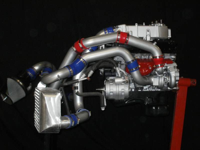

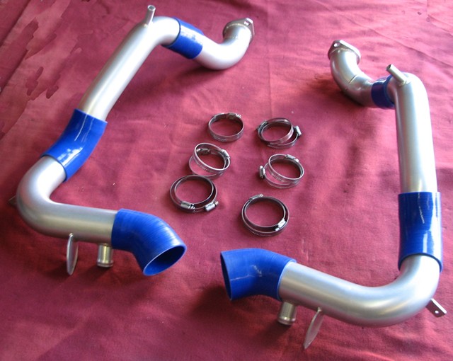

The AshSpec planer inlet piping looks like this:
The stock engine mount is used with some material removed to clear the "periscope" pipe section:
Forgot to add I've already upgrade the clutch and flywheel so should be OK for the power its the xtd one might just do fuel and water pump like you say for peace of mind
:clover: mine spun itself into molten ferrodo. Competition clutch are good if yours does the same.
[ATTACH=CONFIG]83117[/ATTACH]
[ATTACH=CONFIG]83116[/ATTACH]
Cheers for that Andrew, I'm hoping to come out virtually straight, then pop the tube out under the headlights. That kit still uses the same idea of a periscope it's just opened up to remove the constrictions.
