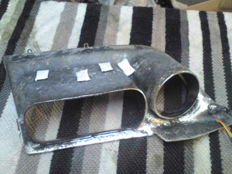

Having changed all the adjusters to metal as usual 50% were broken, i found a spot where i could attach some silica gel sachets :cool3:. You can see the exit point here where i came out with the 3 wires that run the tube light as you must keep away from any warm or hot areas, i did however put on a heat sheath for good measure.

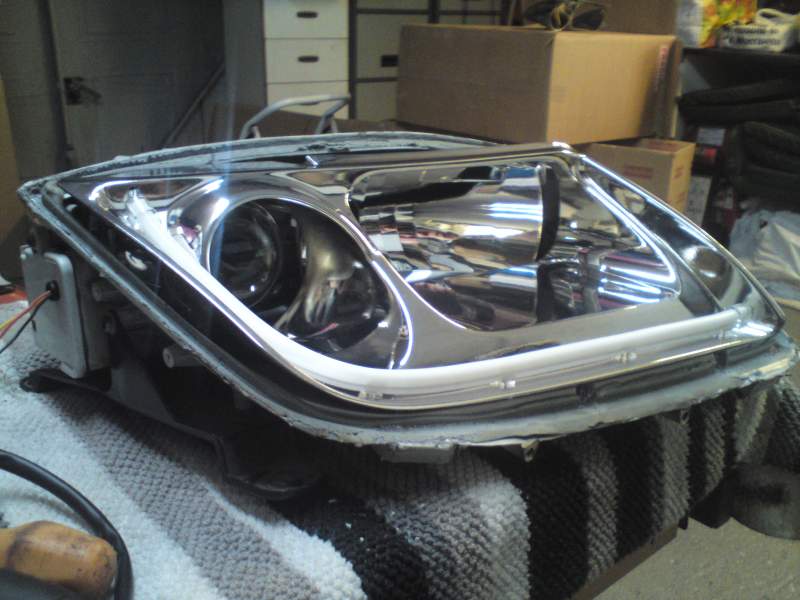

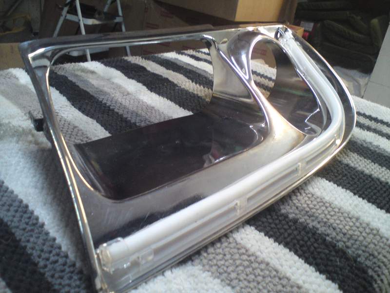

The inserts fit quite well, be prepared to do a little fiddling here and there though, i did all this on a tatty carcass until i was happy to fit on the supplied headlights. I also spent a lot of time thinking about the fitment of the tube before i started drilling and screwing, you can see they come with little brackets and clear end caps. The tube light i had to cut to length and i am happy how it comes down and swings along the bottom.
Offered in the headlight you can see my chosen exit point for the 3 coloured wires, these were severed as they go to a multi plug and i didn't want to be drilling a 12mm hole through everything, wires of course soldered and heat shrunk back together with the use of a grommet.

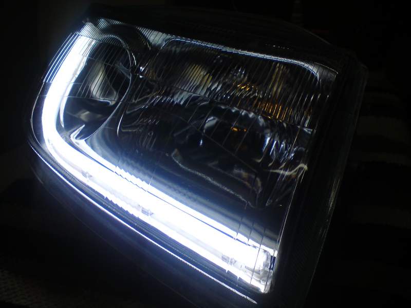

Having got my softest rag out and cleaned everything i put together and lit up for a pic, so this is running light if you like but i expect will be connected to the sidelight circuit.

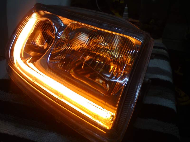

And if you indicate the white goes off and the amber/yellow flashes, indicator turned off and there is this wonderful one second delay and the white is back, i have a video showing these in action and will upload it later :yes:.
