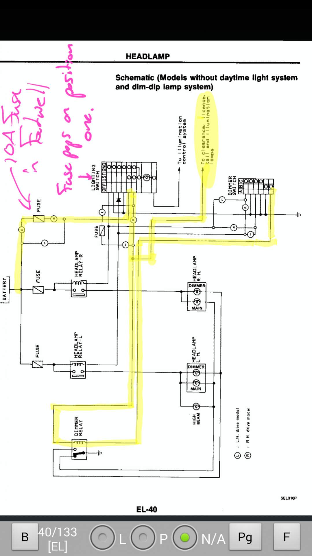

Having made myself very familiar with the wiring diagrams over the last few days I know sort of why. It pops the 10 amp fuse in the footwell which means the black relay under the bonet can not be energised. To my understanding that relay is energised to inhibit the high beams, some sort of fail safe that leaves you with some lights.
To my mind then, somewhere I have a short, that is before the lights but after the switch, it is like connecting the + to - across the battery and as it is pulling through that fuse it blows.
I have done as many checks as I can, most things seem fine and I believe the problem to lie where it says "to clearance tail and illumination lamps"
I have found a few uninsulated ends and covered them but the fault is now intermittent and it is making it very hard to trace. I would like to know what this is

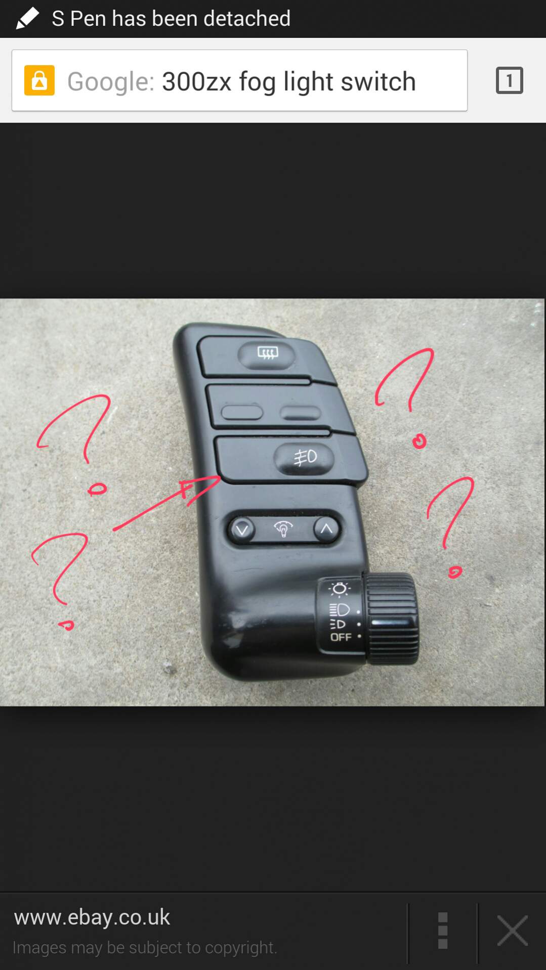

And finally my factory fog light switch on the pod, does not light any fog lights, but has the same effect as the first stage of the rotary light knob. It illuminates the tail lights number plate etc, and when combined with the rotary knob, lights everything but more brightly.
Is this normal? Doesn't seem it to me!

Easier question then, what does this button do on your car?
Does it turn your tail lights on.
For bonus points, do your tail lights get a bit brighter if you have that button pressed, as well as, your side lights on?

IIRC the factory fog light switch on my JSPEC car brings the front fogs on, but automatically brings the side lights on at the same time effectively over-riding to position 1....I'll go check....yes it does.
This was the same on my other Zed too.
The mystery continues!
Thanks mate, it certainly does.

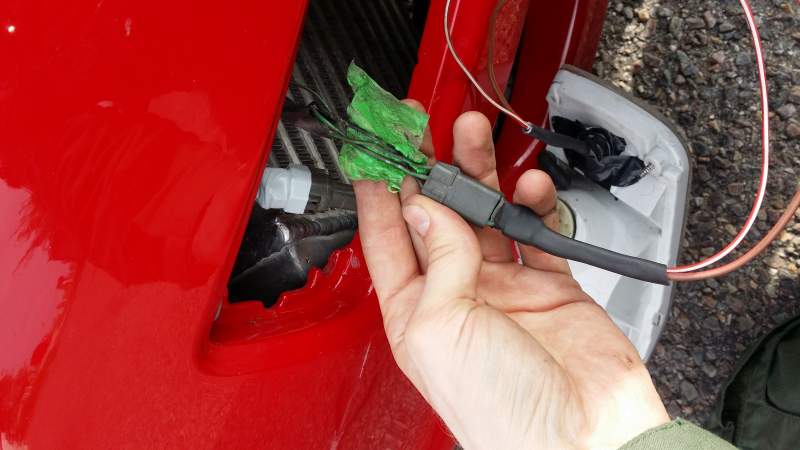

Look at what I found :)
[ATTACH=CONFIG]82997[/ATTACH]
I hadn't read your post phutumsch, but
Don't assume it's all good under the tape
Turned out to be top advice :thumbup: I hope that is it. I have had all the lights out, refreshed a load of connections and weather proofed them with self amalgamating tape. A lot of things that would no doubt have gone crack at some point down the line, now that is pushed further into the future.

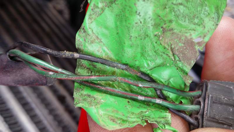

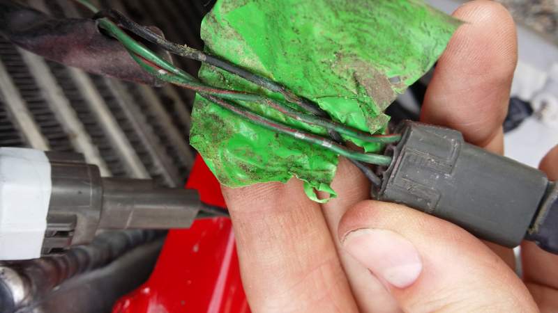

Front right sidelight
[ATTACH=CONFIG]83000[/ATTACH]
Can you see on the close up ^ ^ ^ the live and the neutral both bare under the green!
Ooh grim !! we found that the n/s/r marker light in your bumper had a very wierd wiring set up ! it had 2 lives on it ! obviously it didn,t work so we had to sort out the connection on that but everything else work fine :huh:
