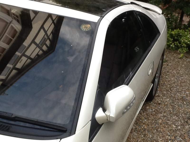

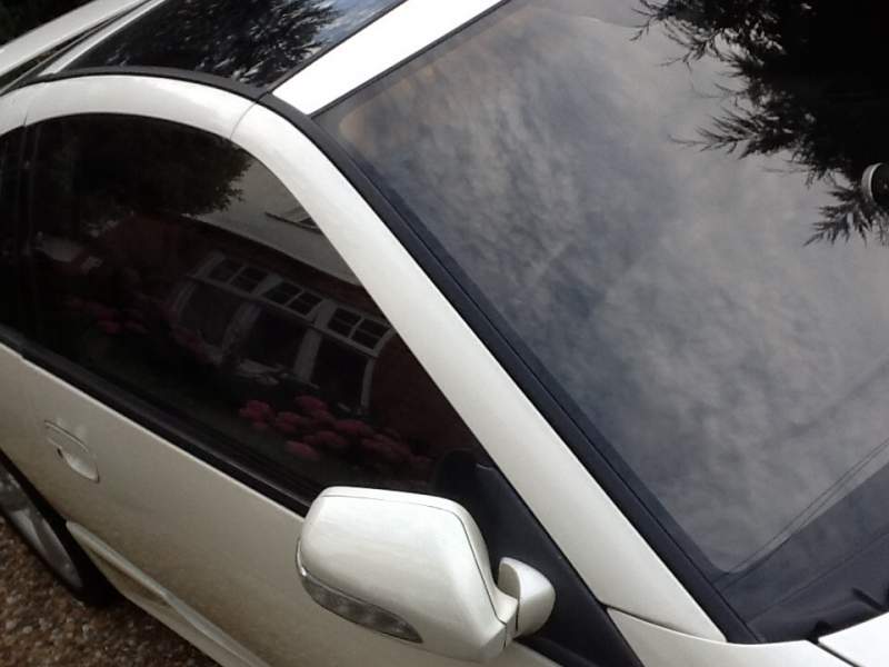

Hi Dan i got some plastic primer and satin black paint from halfords to do mine and they came up sweet. Did the wiper arms too. I washed em in hot soapy water then rinsed with lots of cold, dried them then wiped over with panel wipe and finally a tack cloth before spraying. 1 coat of primer 2 coats of satin black.

That looks like a great finish Ian.

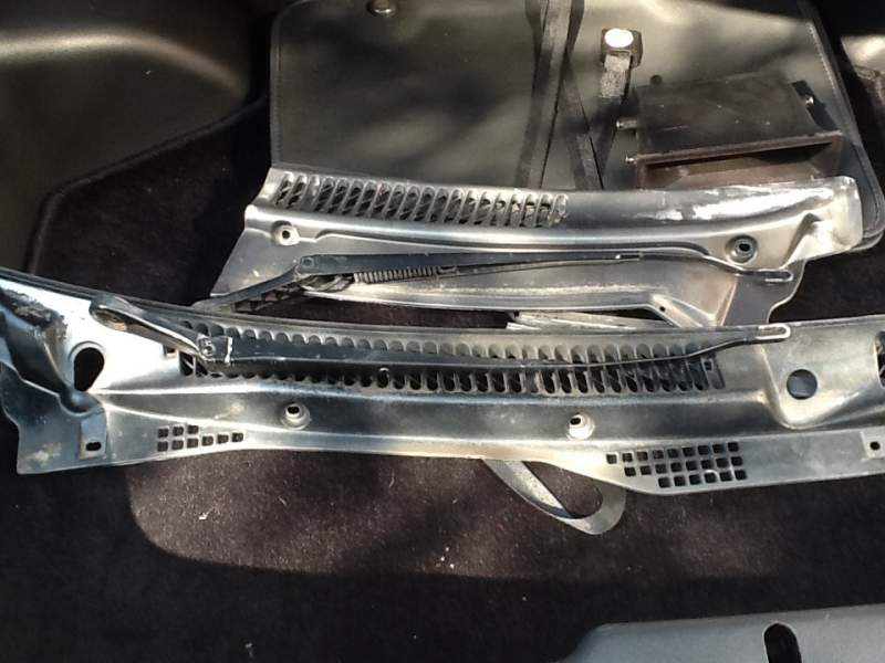

They did dan, took me about 2 hours all in , the wiper arms were a pain though I dowsed them with nitromorse and took them righ back to bare metal and etch primed them before spraying satin. Hardest part was washing all traces of the nitromorse from the spring in the back of the arm, (boiling soapy water and a 1" paint brush, creates some interesting fumes though so beware) !!!!. Worth it in the end though.

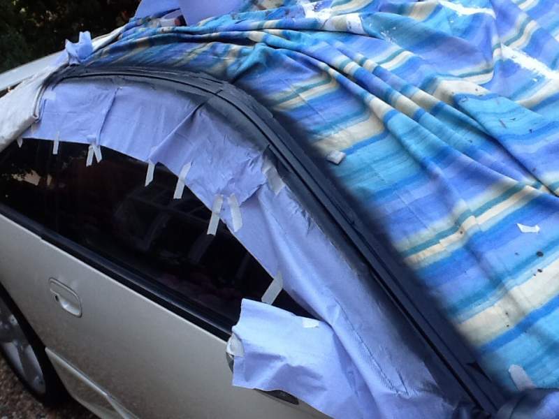

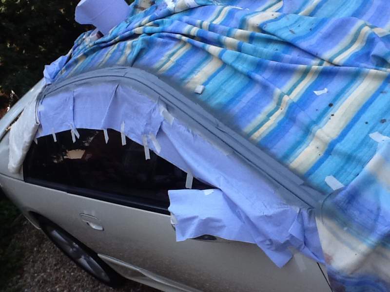

I did mine a few weeks ago took me best of 4 hours scraping trims! Got them primed & plastic painted! image.jpg
Not too bad a job but labour intensive!

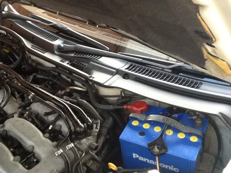

image.jpg the other side![ATTACH=CONFIG]
