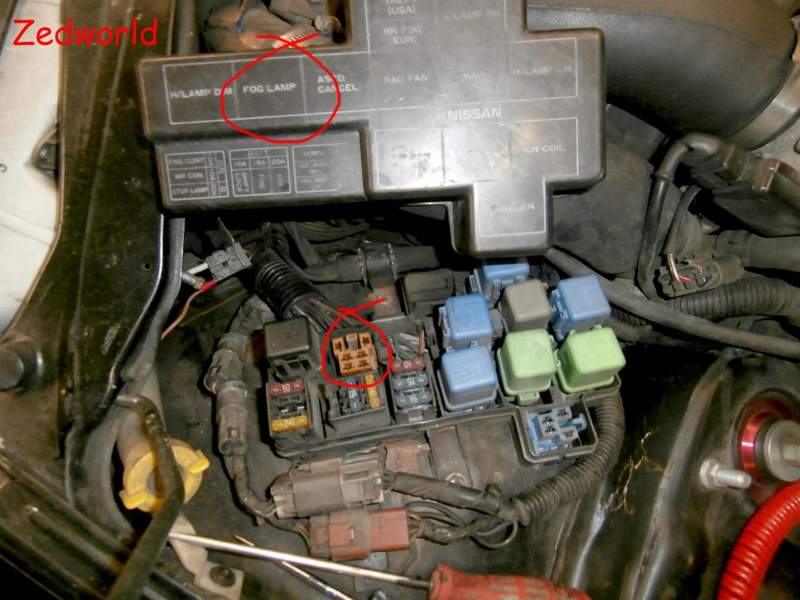

Ok have had a look and the fog light relay under the bonnet which is activated when the fog lights switch is pressed is a double pole arrangement, one set for the fog lights and one set for the side light circuit.
Have added three pictures below, the first so you know where to find the relay and its base, the second and third show the relay ( removed ) and the connection layout of the base. Simply put by interrupting ( disconnecting ) the side light circuit the fog lights will work independent then, to do this undo the fusebox and you can access either one of the side light feed cables as shown in pic 3, cut and insulate it and that`s it.
