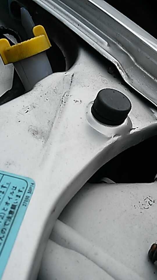

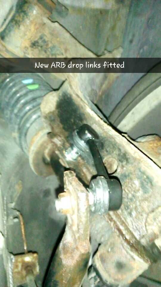

last night I changed the front droplinks on the z. 1431786118965_zpsxj9n8tve.jpg

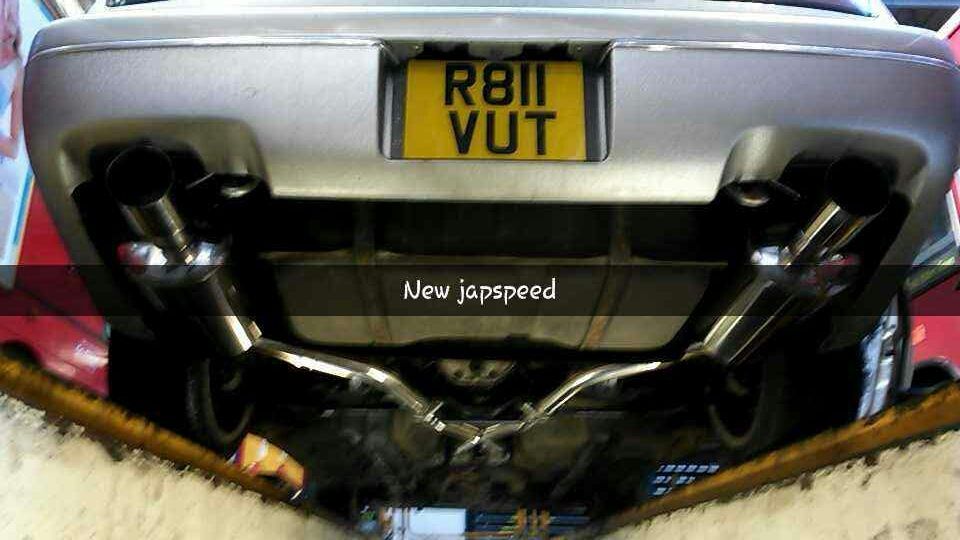

Today I fitted a new japspeed cat back exhaust to replace my rusted broken one. 1435861660938_zpswicbqxe5_edit_1435872990688_zpsyyalqutq.jpgth_Snapchat--6400574405575542460_zpsyt0u79ct.jpg
Drove all over new forest area over the weekend. Its so beautiful and a few people told me how great my car now sounds. Haha I don't need telling lol. Bit louder under load than expected but every note is perfect
Still loving the exhaust lol

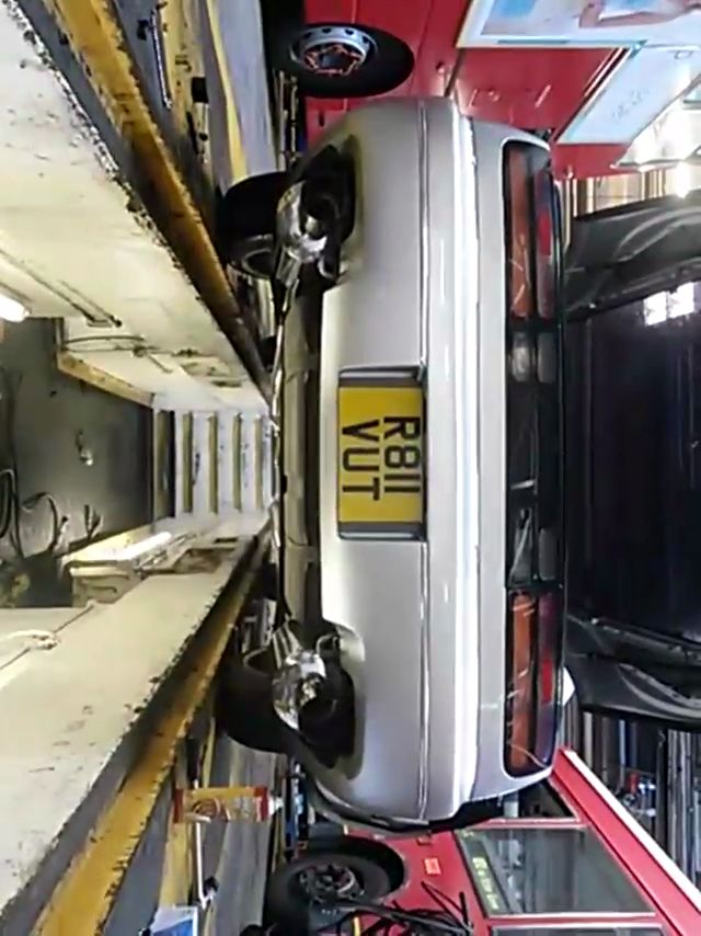

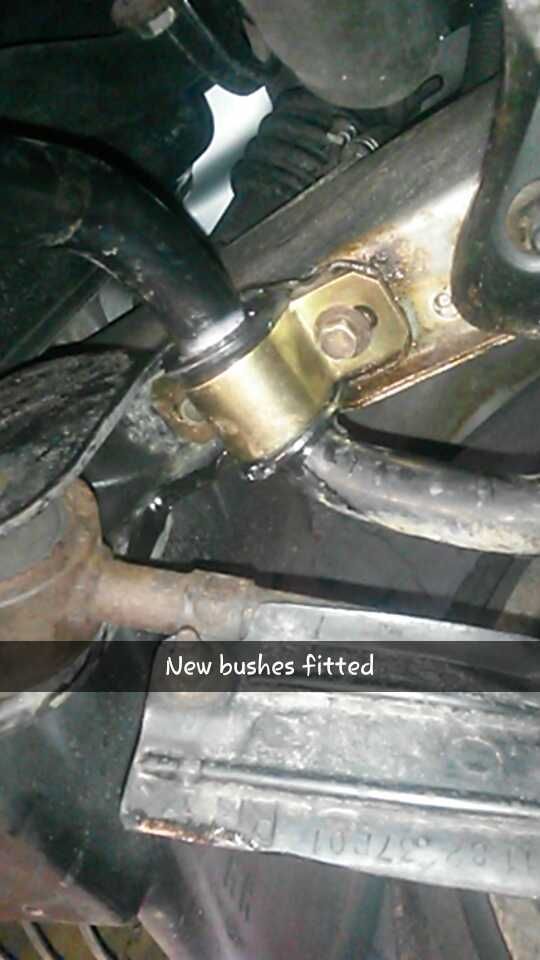

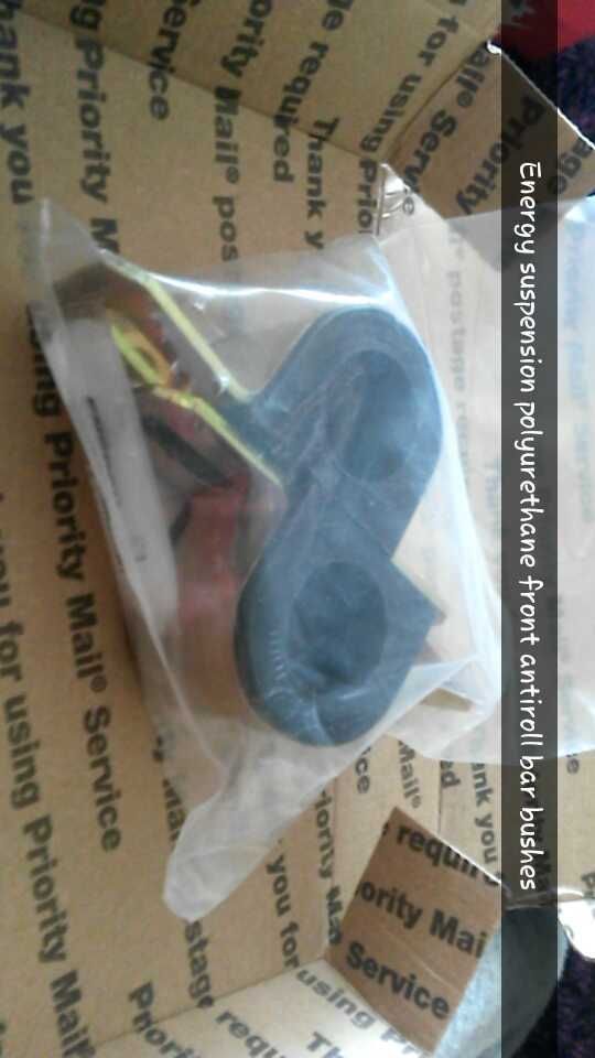

A long time since i updated this. I changed the brake fluid but the master cylinder decided to fail. I had that rekitted and bled the system further until it behaved. In the process we noticed some idiot had fitted the rear callipers on the wrong sides so they were upside down.:headvswal. After that my friend adjusted the handbrake cable and tightened the new alternator belt as it started to squeeal. I changed the haeadligbt bulbs as one blew. Had a few tidy up jobs. And then i polybushed the steering rack. I finally put it up for MOT and all my hard work and money paid off. It passed.
