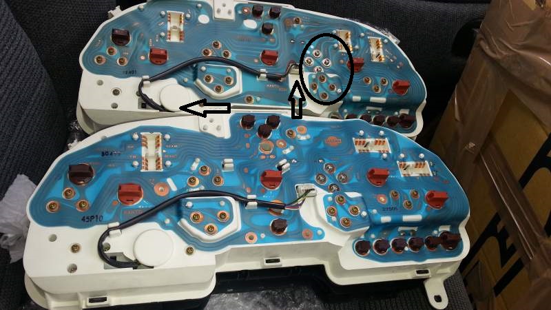

Ok. Bottom Speedo clock is off a UK 1991 TT. Top one is my 1991/2 Jap clock in kph.
Trying to swap the two, but there are obvious differences in the connections...also, you may notice that the centre connection on mine only has 2x pairs of double contacts, whereas the UK one has 2x pairs of 3 contacts.
Can anyone advise on fitting?
Simples!
You will need to open up the units and swap over the speedo/boost gauge sections and also the odometer section as the gearing is different to make the difference between miles and kms.
Opening up the units is actually very easy so don't be put off by that. Take your time, work methodically and you'll figure it out.
This will work, trust me!
Err....ok, , thanks....will have to trust my fat fingers!
Thanks for the helpful arrows...picture taken yesterday so all back together now. Will have a go tomorrow. Thanks for the pointers..
