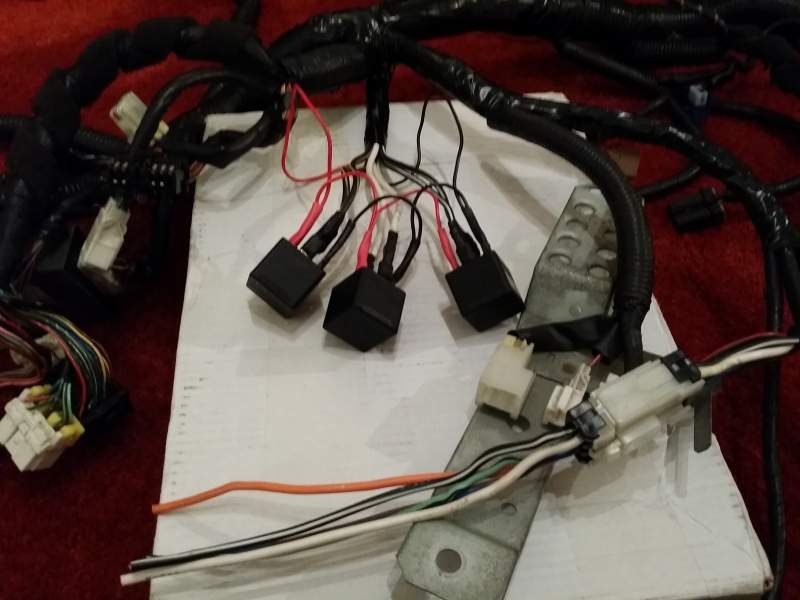

All I can say I've added a wee bit of a DIY immobiliser that cant be seen or tampered with from under the dash.
And it makes a kinda cool clicking sound when activated; however the time the immobiliser is triggered and
you enter the car you've lost that effect, lol.

Na lost now I'll have too wait until you finish it and show us anything like the work you done on the car it's got too be cool

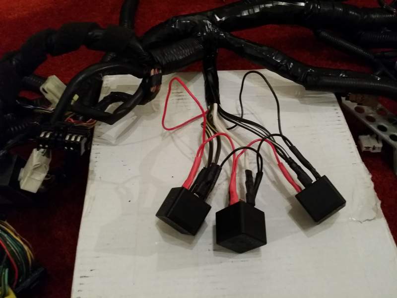

Its nothing fancy to be honest, ive just inserted three relays between all the main ignition cables.
It means that if someone was to try and hot wire the car or tamper with it by stripping the ignition
harness they wouldn't get it running.
The trigger wires need 12v to operate and they are hidden higher up and within the original loom.
