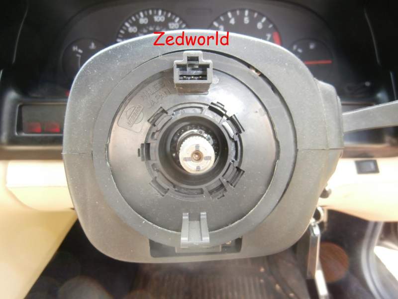

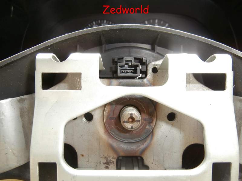

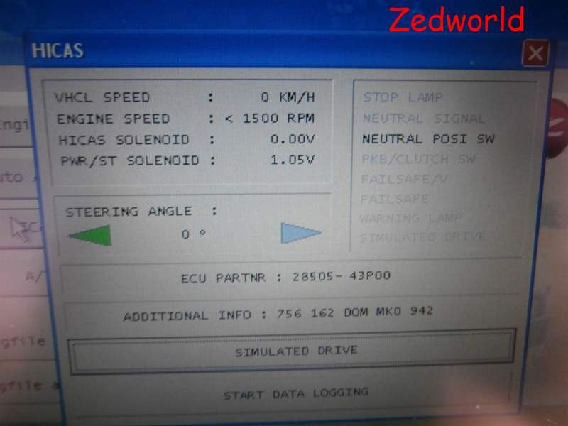

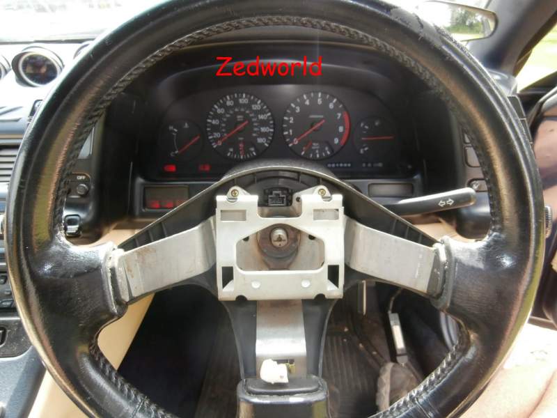

Ok here are the positions you need to know, all the pictures were taken whilst observing the wheel position and the zero point for the hicas sensor.
Pic 1 shows wheel straight ahead,
Pic 2 shows wheel centre section off
Pic 3 shows wheel off and view of the sensor and the relative position for the sensor arc position
Pics 4 shows zero point on the ConZult or similar
If you match all the positions and you still getting a wrong value on the diagnostic screen then it must be an issue with the hicas sensor position.
