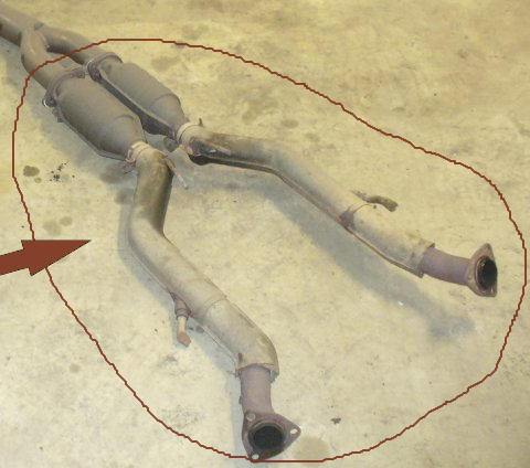

Next question, the TT has a precat, so for now i guess im going to have to use the TT down pipes to cats, as i have an NA set of down pipes and no cats or will the na test/down pipes marry up?
The turbo elbow comes down 90 degrees leaving a horizontal flat to bolt upto, the same as the NA. Aftermarket TT front pipes and elbows have an odd 45 degree joint so must be used together. So if you unbolt that horizontal flange, next to the steering rack and mirror on the other side you should have a horizontal flange to bolt your na decats too. The only snag here is one of the turbo elbows on a uk car contains a precat, so you would be unbalanced unless you removed the precat or utilised a jap spec one, think it's driver side. Genuinely the worst bit will be unbolting it, the nuts on the flange rust and seize and getting the elbow off can be a mare those tight access turbo flange bolts again seize and rust, not fun. Thankfully your pulling the block, makes that wayyy easier.
Again once you strip it down you will soon see what it's all about.
Stock UK/Euro spec cat exhaust sections are like these with the "45 degree" joint:
so you will need to use them and the downpipes from the UK TT engine. The stock passenger
side downpipe has the precat, which you can remove by rodding it out.
