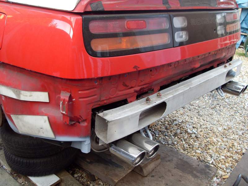

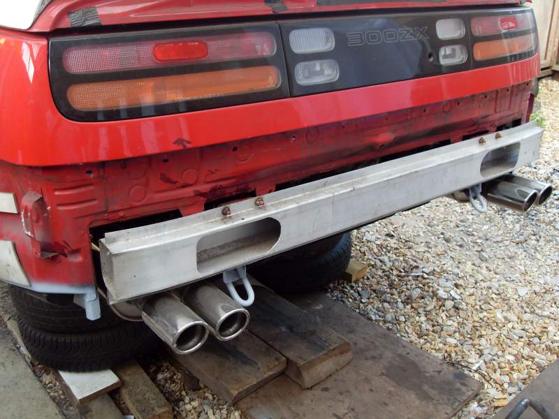

Dos anyone have any pictures of what is under the rear bumper when removed. I'm trying to figure out what metalwork is or should be there on mine without removing it.

pics of inside the rear bumper or pics of the car with rear bumper removed ? can post sum up in a few mins what ones do you need
Gary, thanks for that, if any one has some close ups of the rear qtr area that would be better, out of interest, how difficult is it to remove the rear bumper.

From what I can make out its just a recessed panel a few cm's in, is this metal panel available as a spare?

Simon , Thanks for that, just the ticket, as always. Also thanks Dan, shows me where the bumper is fitted. the issue I have is the bumper has peeled away in the area shown and the metalwork has put up no fight against oxidation.. I have some options, just needed to know what I was dealing with.

they do rust there I had a bit on the inside or there you have marked in red its not a hard job to cut out and weld in new bits I did mine my self. bumper off rear wheels removed plenty of rum to work

Okay, managed to remove the rear bumper, thanks for your tips, the Picture shows where I need to make the "cut" on the panel and then weld on to the corresponding place on the working car, seems straightforward enough... :headvswal
