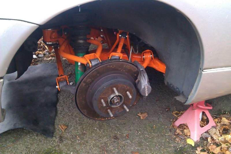

i had to get rear camber arms for mine buddy, the bolts only give 1 or 2 degrees, not something i found noticeable. Also i got rear toe adjustable arms too as you will toe in with negative camber.
Thanks guys, nice setup zed racer, I can't afford the full DW kit at the mo! Adam are the toe arms the short ones?

On my set up( NA of course )I have adjustable top arms and adjustable rear arms(the long ones referred to commonly as toe arms)
Then you can set rear camber and toe in/tracking. This was done without any issues. I didnt get the short front adjustable ones as they arent really necessary. Nice extra if you have them tho.

no buddy the adjustable toe are the rear ones, as i knew you had an N/a and didnt have hicas you wont have adjustable track rod ends. as pete said, i didnt find the short ones a necessity so only have adj camber and toe. i got the adj SPL/SPC (the cheaper of the 2 sold from z1)
