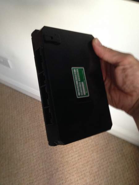

It could be a problem with the control pod or even the specific ECU which is near clutch pedal behind the dash.

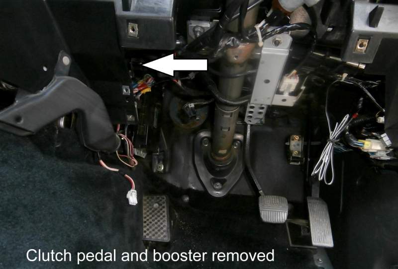

The control amp is the specific ECU thingy I've mentioned. It is behind the dash to the left of the clutch pedal.
