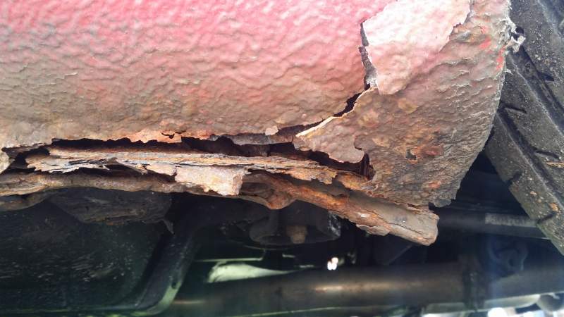

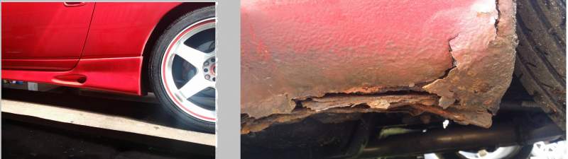

Guys, this is a big one, I need a shoulder to cry on, and a welder :(

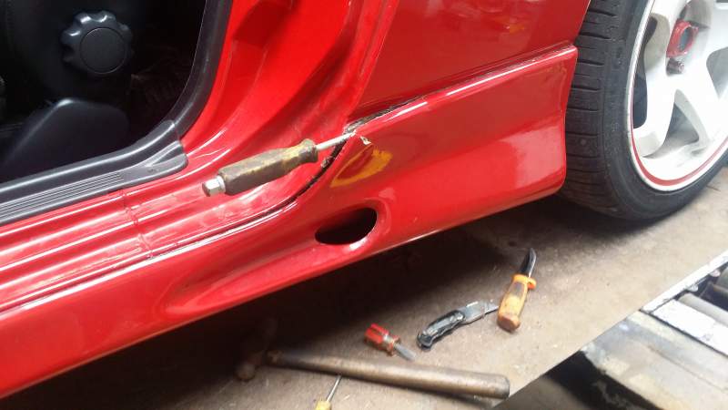

My car failed it's MOT on rust, I went elsewhere and it failed again. I had always planned to do a full on, 'glass out' respray at Bodymech probably next summer but can't really afford it at the minute. The car is out of MOT and it is here...
Insurance is up in 2 weeks, I am skinto because I just got the mechanical refresh done (K-Sports, Clutch, Cooling) This was because I could only drive it very gingerly as it was, the brakes were crap and the clutch was slipping. But now, it is knackered. I can afford the insurance I planned for that, but any big repair and we are into tins of beans and "please Mr bank manager..."
I feel awful, I feel like an idiot, I don't stop telling people how much I love my car blah-blah, but it is now borderline, "spares and repair". The garage it is at could patch it, but it will be an agricultural job, I think were past staples and glue, and into re-constructive surgery with this one.
Do I re shell, do I repair, do I retreat :wacko::no::sad:

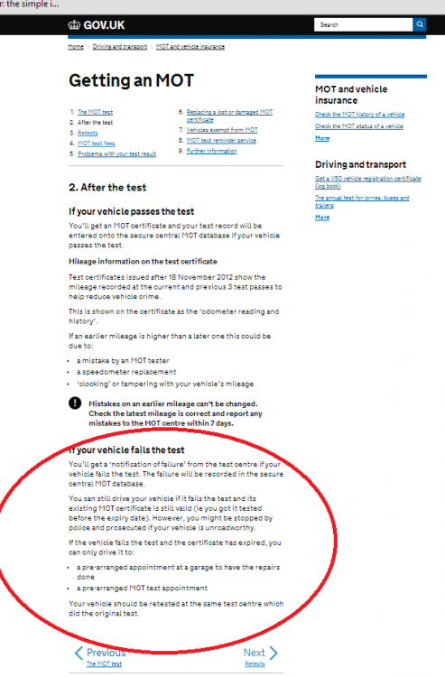

And, If I drive it to bodymech for repairs, am I gonna get nicked. I am not taking the piss, I am taking it for specialist repair without MOT. And I will do it between midnight and 8am.

I will collect the car from Forres tomorrow and drive it to my parents place in the North East. Then on Thursday get it to bodymech about mid day. 2 journeys are better than a big 9 hour one, that is common sense and surely a police officer would rather I didn't drive 450 miles in a one-er in efforts to please VOSA.
It will then get sorted out by the lads at Bodymech.
Alan is going to Email me proof of booked repairs and I have printed out this...

Andrew G, it is out of MOT so in that case I will drive one 9 hour drive then, quite annoying that the sensible safe stop in the middle option is not permitted. With car transporters, I don't think I can drive one, I am 24 and do not have a trailer license.

The transit idea really is the best option mate. Even if you are within the law it's not worth the aggro, a lot of coppers will drag you into the police station or court before discussing actual law, the sentence "if you disagree you can always contest and go to court" is a favourite as they know no one wants to do that.

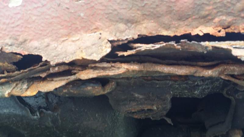

just seen my name mentioned in this, yes i've got a beavertail but i dont fancy doing 6hours drive to the north of scotland, and i also a plater/welder but i'm unsure how this repair could be done. usually when patching up i'd usually just got the rot out and replace. i have a breaker here if you wish send me some measurements and i'll cut the sections out and post them to yourself, i'm quite sure there will some1 in the north of scotland who can weld the sections back on, give it a clean up put your skirts back on to cover the bodge an jobs a gooding!

I didn't announce what I was going to do because too many people had offered more sensible solutions but I drove the car to Bodymech where it will stay for a good few weeks. The drive was probably legal, I had a lot of paperwork printed off and on the passenger seat, rules and regs, emails, and all my license and insurance stuff; but it was about as stressful a drive as if the boot had been full of guns, girls and crack!
I was really shaken when I saw the damage/deterioration, after so much time, effort and money to get a slap in the face/wallet like that was hard. But I am too attached to the car, too stubborn to be beaten, and not cold enough to watch my car be broken.

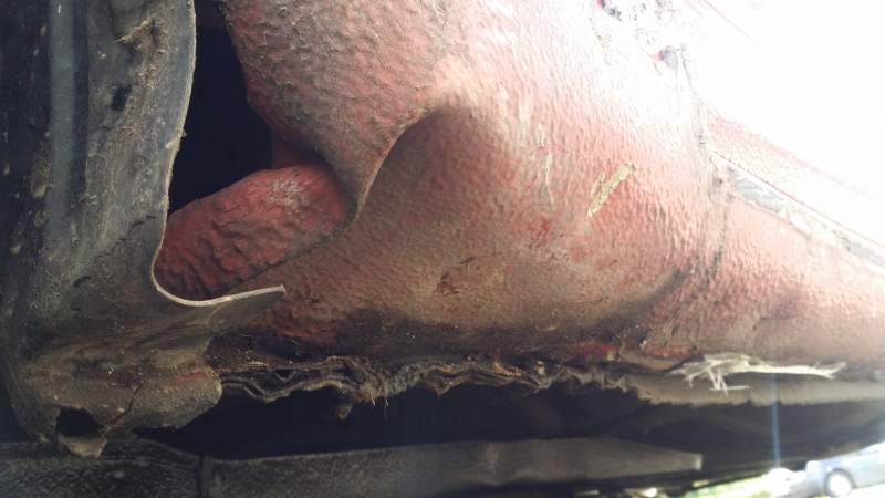

How far forward is the rot going???
If you can borrow a borescope and look inside the sills it will give you an idea how bad it is....... but be prepared for it to look like the pictures of the titanic after 25 years at the bottom of the ocean......
When it is done make sure they use weld through paint and treat inside the sills where you can't get to before closing up the sills after repair.... I cleaned up as much as possible......I used a zinc primer and then painted as much as possible with spry hammerite....
When welded closed I used the interior holes to pump Dinitrol rust killer and then a week or so later a waxoyl type treatment to finish with.........
This will be a yearly top up for me from now on........
