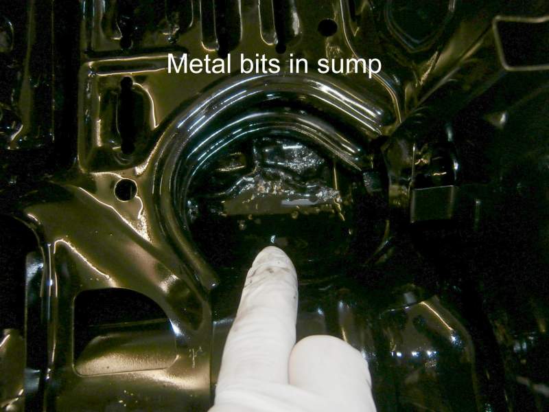

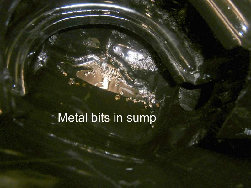

The resullts of little or non oil, long story but the end result of a mistake made by an apprentice most likely at oil change time:glare:

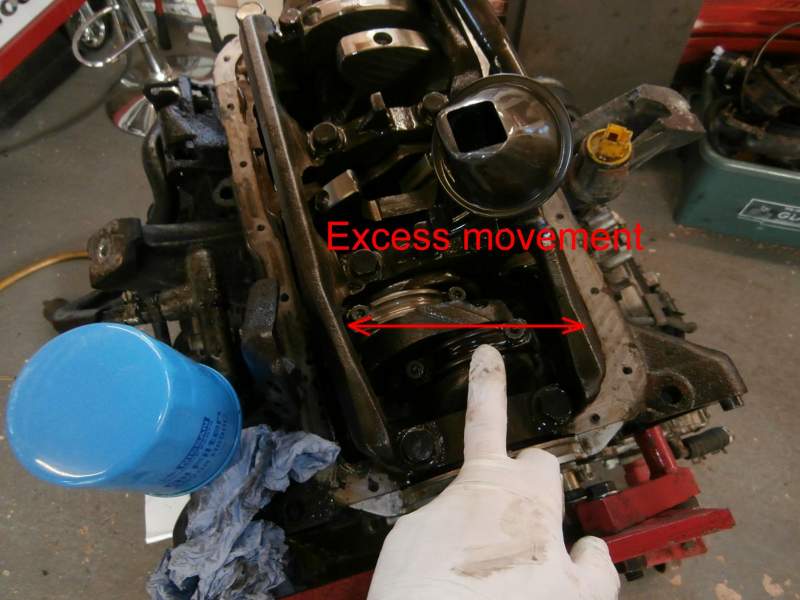

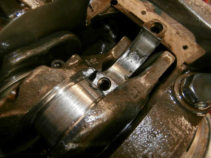

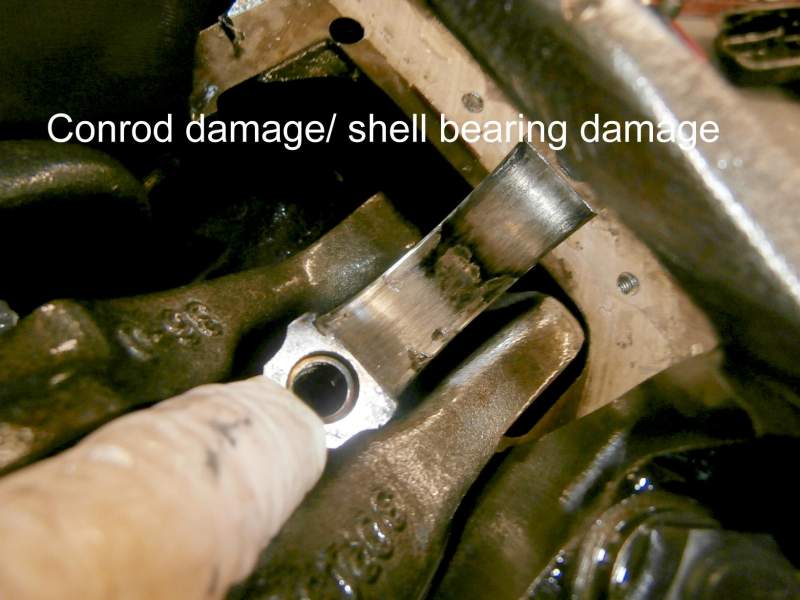

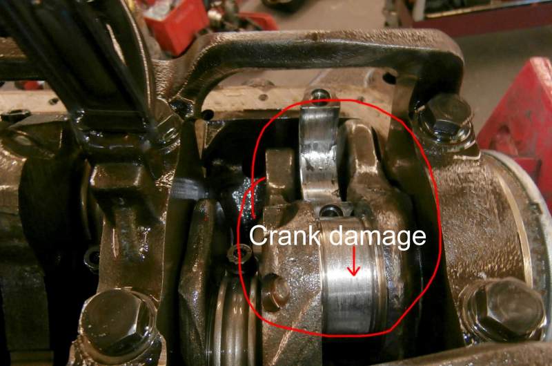

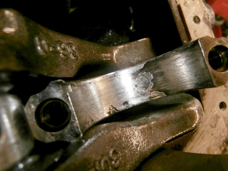

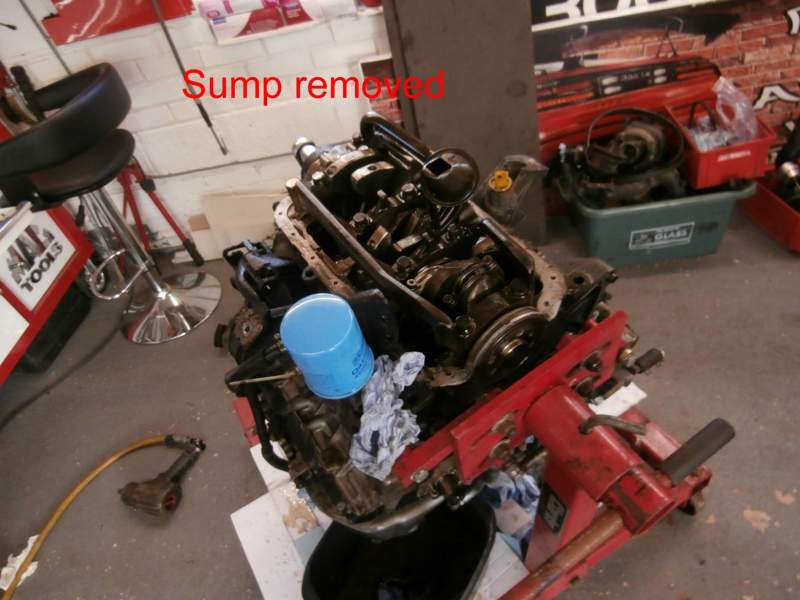

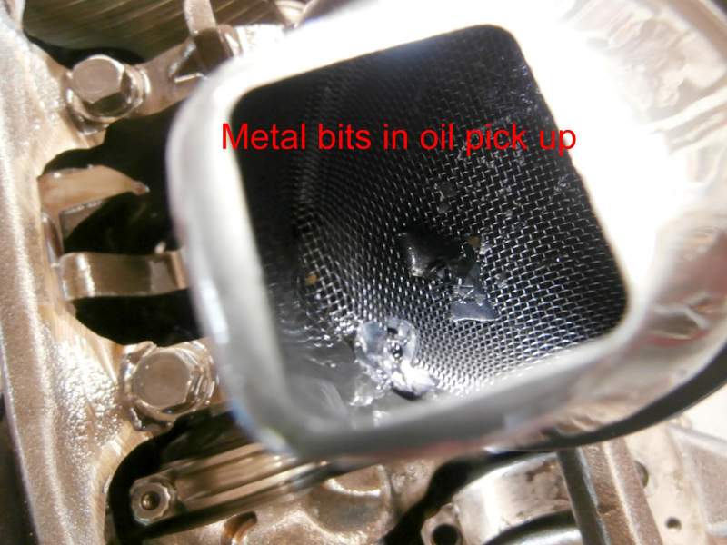

Heavy knocking and no power, was transported to Zedworld by " the other garage" to see what the situation was, soon as it was run it was clear internal damage had occurred, so whip it out of the car and on to the engine stand for closer inspection.
During the strip down it was found one turbo almost to tight to turn, once the sump was off the amount of side ways movement in no 6 bearing was huge!! and well the rest are well mincemeat!!!
