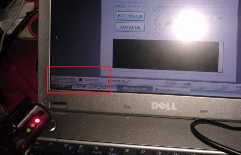

Graham, thanks, that worked, once it was sorted i took it out to the car and plugged it in, com 3 seemed to be the best, but i just couldn't get it to work as i thought it would, picture shows the screen . am i right in thinking that the "Disconnected" should read "connected" the black dot should be green and the comm port should be shown. Any ideas on how to give it a kick start?
Rich
When everything is connected and you click to connect, do you get any error notification?
Also, when all connected, dose the device port show up in device manager?
Is the port showing any errors?
You need to make sure that the com port on the software matches the device manager, normally your pc does this automatically, i would imagine com port 3 is already in use on your laptop, normally com1 or higher up the range say 10-15 may be available.
Go to your device manager in windows and see what com ports are free and try to change it on the consult.
