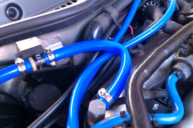

Ok, so really need one of this if anybody has one. After taking it out for it's first road test since fixing the brake vac lines with 10mm silicone hose i opened the bonnet to find this:
This is exactly what I was expecting, the hose almost fully closed under just idle vac pressure. Imagine what it's doing when your dropping down a gear and the vac is at it's highest!!!!
So, before i kill my self with lack of brakes, I need the correct moulded silicone pipes.
Put some braided hose in for that part at least it would keep with the tidy looking hose youve got going on there.
