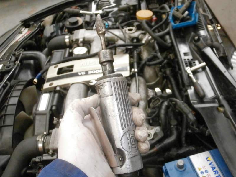

Cheers for that! I'll try a carbide burr with a bigger air powered dremel. Going to prep all of the remaining injectors so they can be changed easily WHEN they go
Exactly what i used to do mine , a dremel,s just not man enough and would take forever , air die grinder and a carbide cutter :thumbup1:
