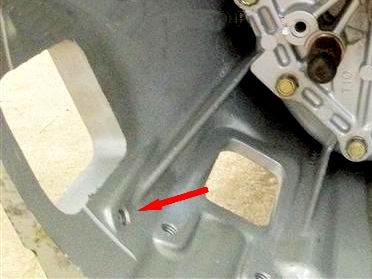

id have a go at helicoil, then no drilling required! i cant remeber the angle of the starter but the 5 o clock position rings a bell?

I Spose that depends where your stood lol, looking front the engine towards the rear of the car it's about 7 o'clock the bottom ones pretty accessible the one above the trans tunnel is in the way a bit if you were gonna drill it. Being aluminium though, and only 2mm less really as you don't drill at 12 to get a m12 thread, It's likely about 1mm of material to remove.

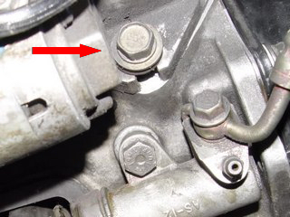

Sorted, after inspection I found the top one whilst a little loose was fine, the bottom however was completely stripped. So I sorted out a longer bolt for the top. The bottom I took a 10mm drill bit and ran that down the old stripped thread, there was actually enough room to do this with my drill, spot on, (There wouldn't be enough space to do the top one in this fashion.) tapped it at m12x1.75. I then used a depth gauge to gauge the material thickness of the box and the starter motor, 20mm and 15mm respectively. Then shortened the Allen head bolt to 35mm the 2mm thick washer helps to stop the bolt popping out the back.
Obviously I had to open up the slot on the starter to accept the new bolt, a set of files soon sorted that. So that's it done...
The Allen head bolt makes getting the starter on and off much easier, being nurled it's nice and easy to wind in. Next time the box is out il do the upper one I think just for symmetry.
