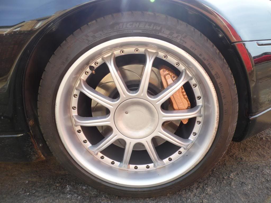

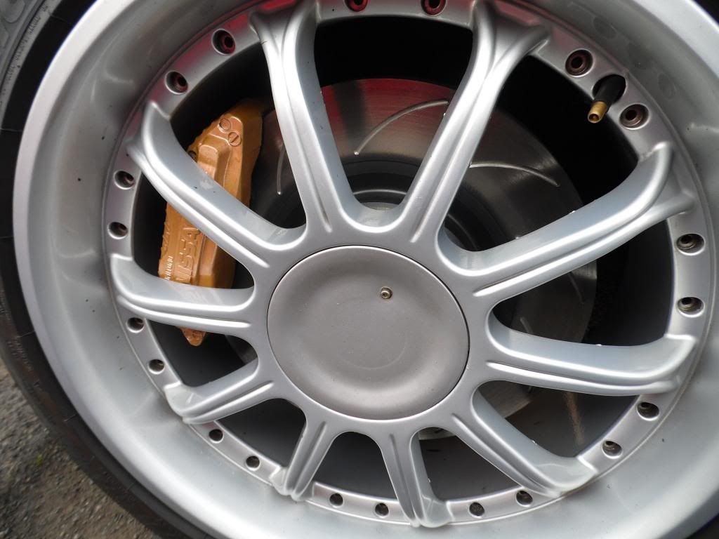

I literally fitted a pair yesterday! You need a caliper relocation bracket, either made or they're available on eBay and you need to remove a couple of millimetres from the leading edges of the calipers or they catch the edge of the disc.
Other than that, the discs appear to be a completely straight swap! :thumbup1:
Mondo, I know its early days but can you feel a big improvement from the larger discs and extra leverage?
I haven't been very far at all since I fitted them and they obviously need running in, but there's noticably more "bite" from them even at this early stage :)
