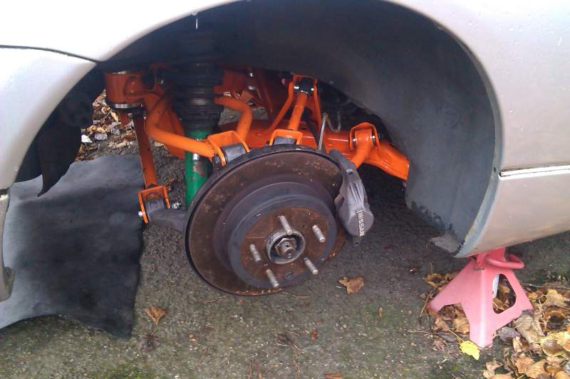

IMO... you only need a pair of adjustable top arms and some rear NA toe arms.That allows you to get the camber and toe in at the back adjusted to suit your intended use.
All the shiny/orangey/bluey/chromey stuff is made in China. They are cheap cos they use cheap spherical joints that wear out quickly.
However they last long enough on limited mileage cars like ours

Some of the US stuff I believe. Stillen?? AMS???
I just bought the cheap stuff as I hardly drive it anywhere.Been to Japfest today... first drive this year.
Put plenty of grease on the joints .
Works for me.
AMS is all Chinese as well Pete, Godspeed too. Stillen, Powertrix, SPL and Z1 produce some good quality products.
