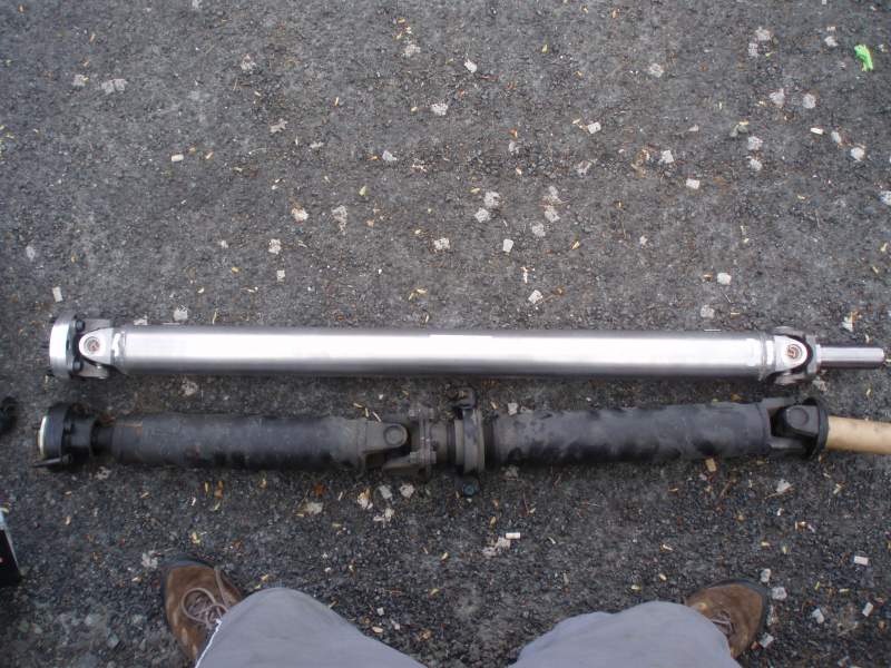

one of the first mods I ever did. Aluminium shaft from Z1 Motorsports..
[ATTACH=CONFIG]79198[/ATTACH]
Interesting. Had no idea Z1 props use a different forward joint.
