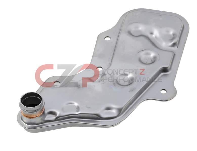

O ring on gearbox strainer
O ring on gearbox strainer can someone tell me if the o ring goes on the top part of the tube or in the recess just below

iirc it goes into the block and the filter pushers up into it...best double check.
Ok so ive re done everything I did last fortnight hoping I would find something thats causing the problem.... first off I wasn't sure where I had put the o-ring on the strainer as it basically fell off as I removed it. But worked out it just slips onto the top of the pipe.. second thing was I checked the electric connectors one clicked in as I pressed it which made me think that may have been the cause. Placed new o ring on and put all back to together .. topped up according to a online guide.. shift through gears while being filled. 3.5 liters. Then took it for a drive to my disappointment its exactly the same :( my mechanic friend who was with me was also baffled.
