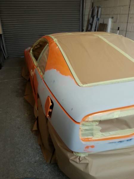

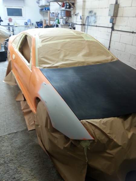

back in the paint shop. when i had my car painted it was fine but after a monthor two a few tiny micro blisters. we recone the blissters were caused by a solvent attack on two very diff paints that were not left long enough to dry between coats, and that caused a tiny bit of mouister that was traped to work its way to the surface in form of a tiny microblister. any way as promised im painting the bonnet orange to as well as the front valance. pics to follow soon.
