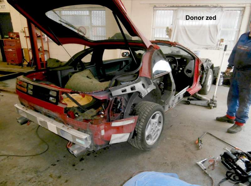

Be assured nothing will fold up, nor will the subframe fixing be any problem, been involved with welding repairs on zeds for years and even the corrosion weaken them to a point that heh welder would need to take any bracing prevention.

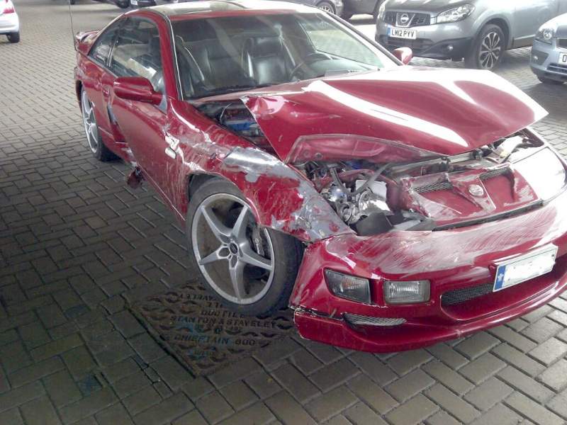

To prove a point remember the repair to this:
and the donor car this:
With the sill, rear quarter and return into the pillar removed no bracing needed and nothing moved.
Jeff TT

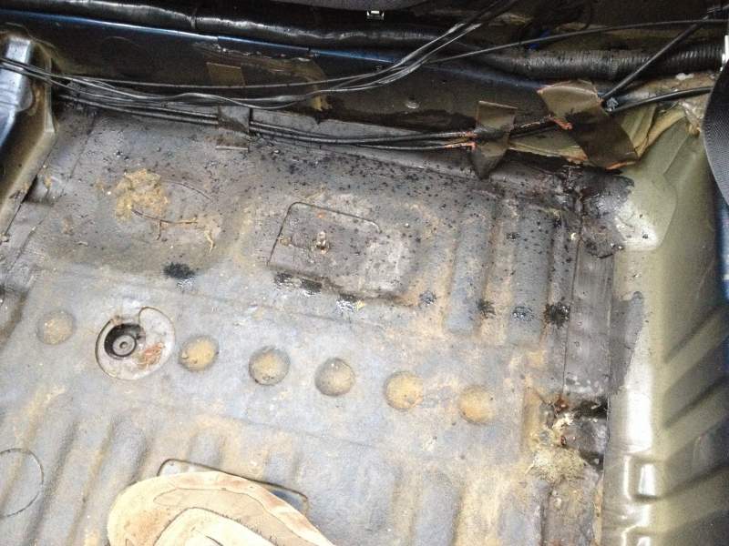

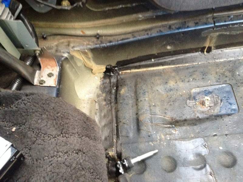

Well I took the carpet out today to see how bad the floor pan was.
Well the floor looks good as you can see (any water is because it was pouring it down and the door was open a bit and I hadn't realised).
I know there are two holes in the floor, one is below the rear seat area but cannot be seen from within the cabin. The other I think is behind the ECU's in the footwell, so will take that out once the car is on stands.
