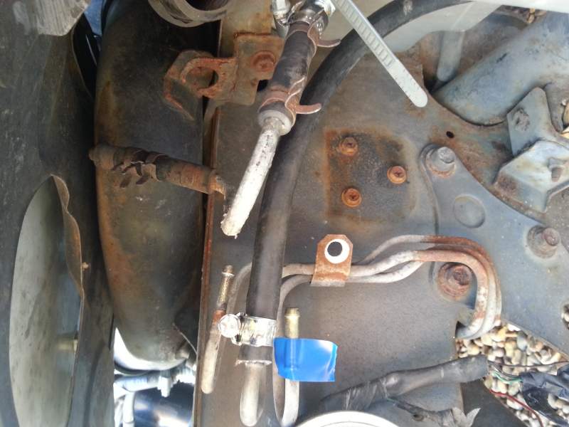

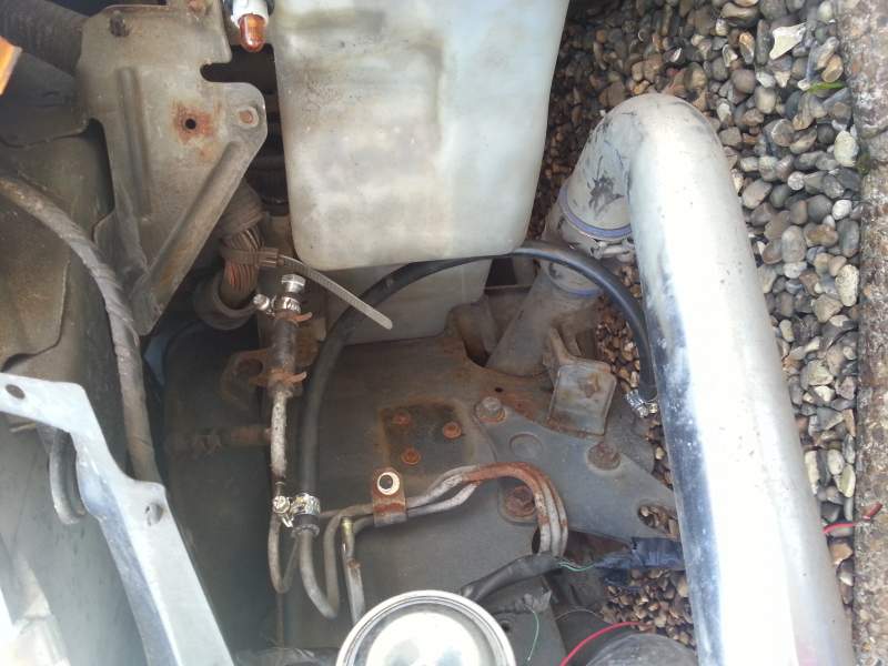

Here are some pics of my carbon canister that i removed today but need to ask a question. that is? on the removal guide it says to do what ive done in the pics, but it says in the guid im sure to leave the pipes open and not caped of.the pic of the pipe with blue tape on is there to show you what pipe i mean.this pipe when the car is running has a huge amount of suction/ vacume on it. question is should i blank it off or leave it sucking?

That pipe ends up on the back of the balance bar. If you follow it back to the bar you can then plug it at source. If you leave it open you'd get a boost leak. Once you've capped the BB side you can remove all that piping if you want to..
HTH
thought so ,cheers ,ill get rid of the other pipework laters next time when i got to remove the throttle body pipework. the other pipe can stay open i guess, theres no blowing or sucking there in that pipe. cheers steams
