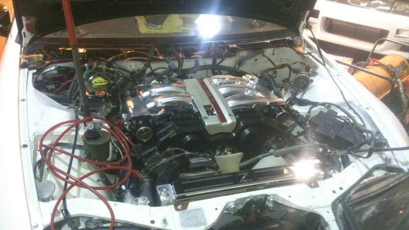

Lee just sent me a picture of my extremely clean plenum. Looks like a brand new engine. Nice work mate!
Saw this last time I was at Lee's place, looks the mutts.

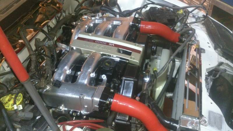

The engine is now sat in place & should be running sometime in the week. Lee sent me this teaser picture, really can't wait to see it now. He's also helped me out with a lot of missing parts, stuff that I didn't even know was missing.
Lee is like that, it looks good buddy the paintwork is a lot better than people are saying too as there is a lot worse out there! I'm looking forward to seeing it moving under its own steam!
Same here! Think Lee is aswel so he doesn't have to push it out every day. Hopefully the paintwork just needs a mop over it & a few bits touched up

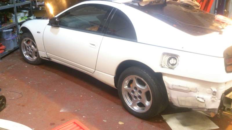

Just got back from Lee's, the car is really coming along now. Will put more info up soon as I wana get my tea but here is a few pics. New wheels aswel, 4 UK rims.
wont be long now Tom...:yes:
Can't wait to have it back mate its gona be a great zed, everything Lee has done is spot on! Your old wheels have really transformed it aswel.
bargin of the century mate them rims..well done:)
Coming along well Tom, looks good on those rims! Still not found the chrome centre caps, but will send them to you if they show up!
Thanks Baz.
