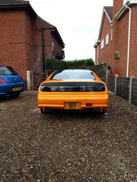

theres me the last couple days slowly stripping me car down again to have her repainted again as i wasnt 100 percent happy and want to change a cuple of things when my nice clean sharp looking bit of exspensive black perspex strip that once looked like this.

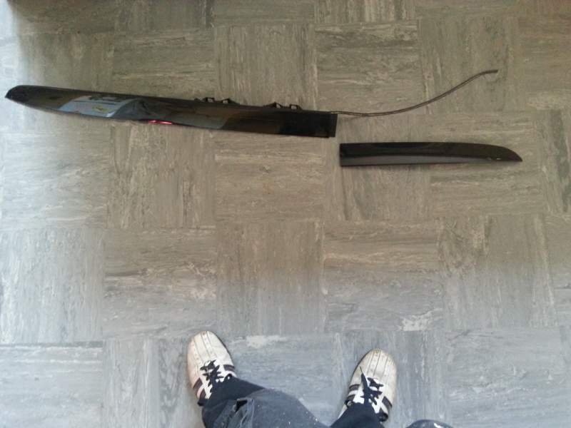

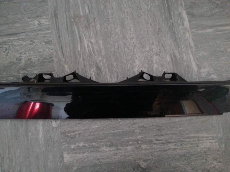

to this in a snap of a secound
ouch that just cost me about a tonne i recon, rubish. needs to say that the air was blue just when one of my partners friends pulls onto the drive. put tools down until tomorow now cas dont want to break out else.

Don`t feel too bad they are made out of the most brittle plastic known to man! you should see how Nissan had to package them when new, I bet half of the cost of them is the packaging.

Is it actually possible to remove them without breaking?! Must be a method, surely
Hammer? I tried being gentle maybe just try the opposite to the logical route sometimes works.
broke that myself the first time i removed one, i've now replaced what ever it was bonded with quality double side sticky tape for easier removal next time!

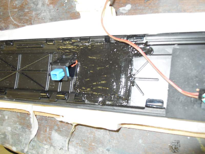

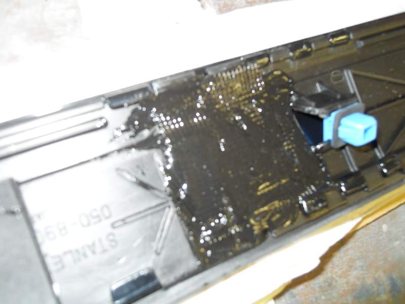

After having one break , when i bought a new one i reinforced the weakpoints on the back with bumper repair glue and mesh , just in case !! lol
