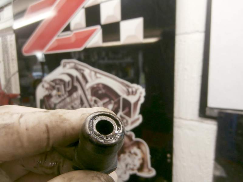

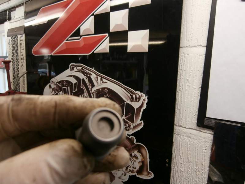

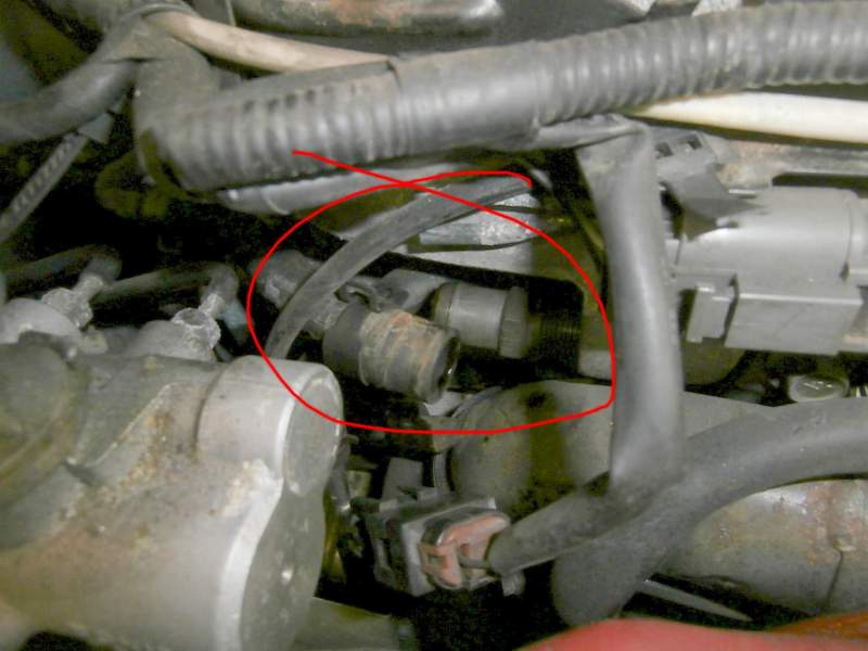

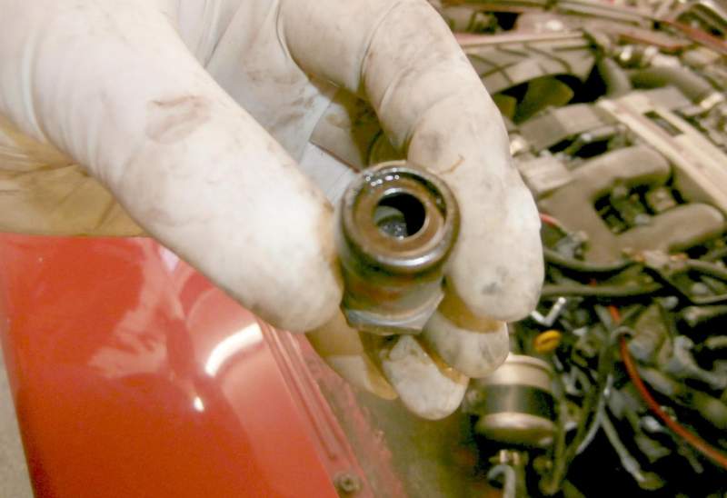

Okay the pcv valve topic has been done many times but never wanting to miss a good photo opportunity a pair of really knackered valves presented themselves today and the camera was close by as always.
The breather system relies on these one way valves been fully operational to prevent oil laden air been drawn into the combustion chambers and causing exhaust smoke at tick over.
The two valves were completely gone and was clear to see the problem, however sometimes they can appear to be ok but be weak or debris preventing them closing all of the time, replacement is the best option given they are not too expensive.

What they should look like....
