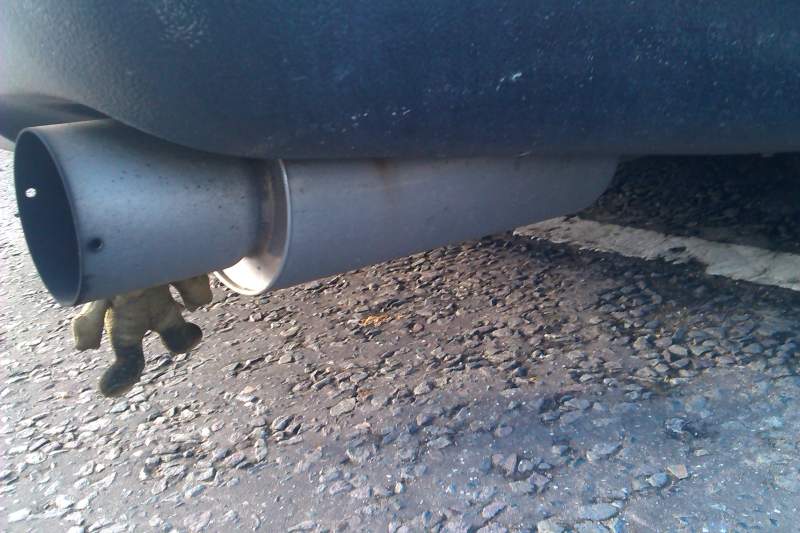

As a follow up to my jasma code thread, what exhaust is this?
As mentioned before it has sr 051 622 on the plaque.
