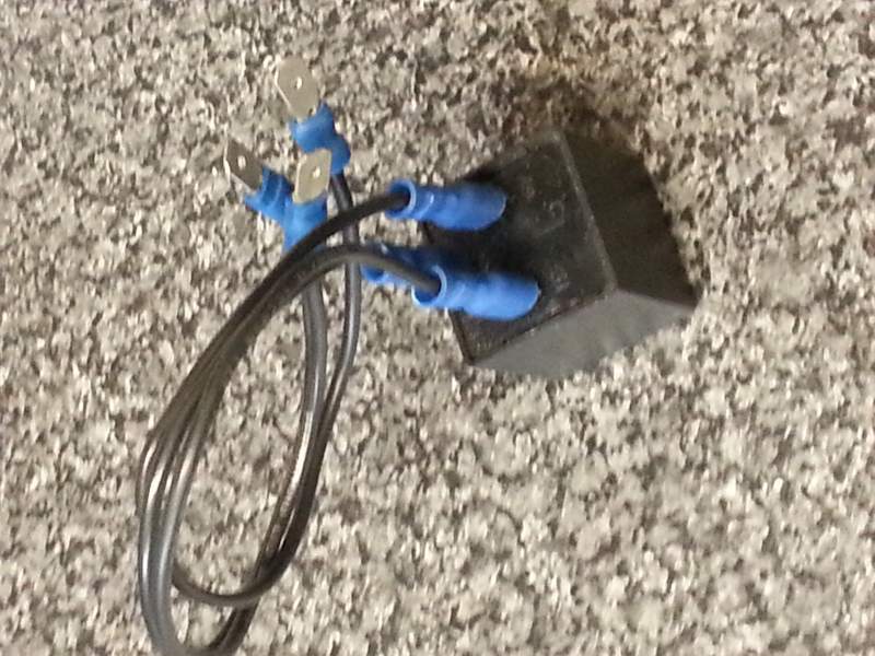

so all i need is that resistor and that will rectify the rapid blinking?
If you get that one, you will need to fit it like this:
http://www.300zx.co.uk/forums/showthread.php?133770-led-flasher-mod
Which is what Spin Doctor did on the last page (kinda).

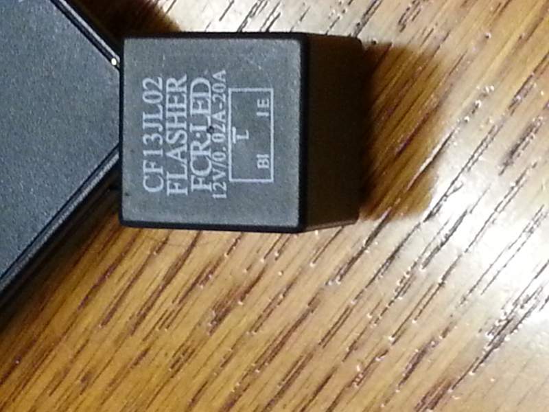

If you buy this one:
http://www.ebay.co.uk/itm/Fix-Flash-Rate-Turn-Signal-Flasher-Relay-LED-indicator-bulbs-3-PIN-CF14-JL-02-/290726947765?pt=UK_CarsParts_Vehicles_CarParts_SM&hash=item43b0ad2bb5
It should directly plug in as the pins are the correct way round.
As a point of note about your earlier post.....these are not resistors. It is a relay. Generally fitting these will mean if one of your indicator bulbs blows you wouldn't get the fast flash to indicate it.
It won't do anything for your brake lights if you are having issues with those. These are for your indicators only.
