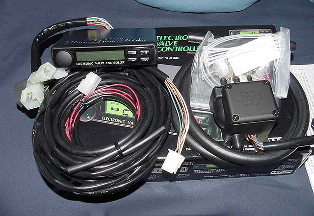

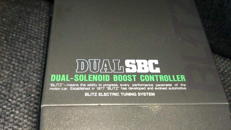

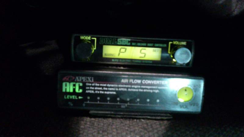

What boost controller are you running?
Im going to order a boost contoller and wondered what you are all using..
I know theres AVCR, theres Greddy and Gizmo.
Any other options and whats your preference?
Cheers
