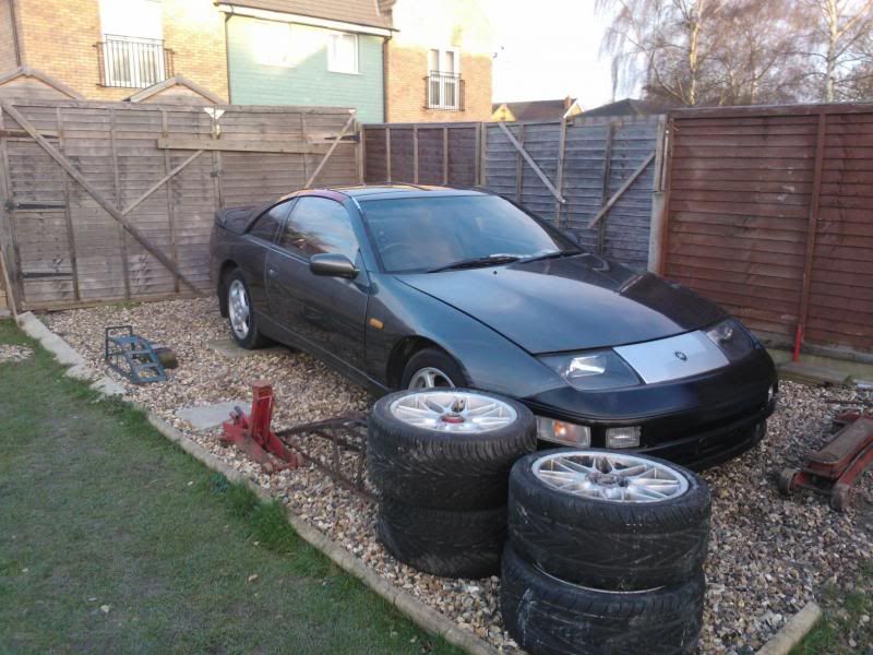

Hi Guys, just thought you two would want to see the photo below as my appreciation of the effort to get it there has not diminished with time. So do you notice any differences since you saw it last...
