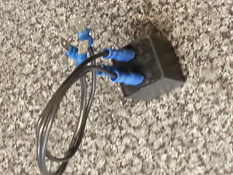

Relay ready to go
Got me a relay ready wired ready to fit . just need to knwow what goes were please. its the relay from japan to put the flasing lights back to the norm speed after fiting leds bulbs .
Basically unplug the connector from the current OEM one,
fit your new one "upside down" if you see what I mean.
You'll need to bend the 2 spades on the top pin 90 degrees to make them fit when you plug it in.
You're indicators won't work at all if you put it in the wrong way. So it's pretty easy to see if you have got it wrong. Then just switch it round.
cheers mate im sure theres a pic of an old thread ill find it laters after i attempt it tomorow , cheers
