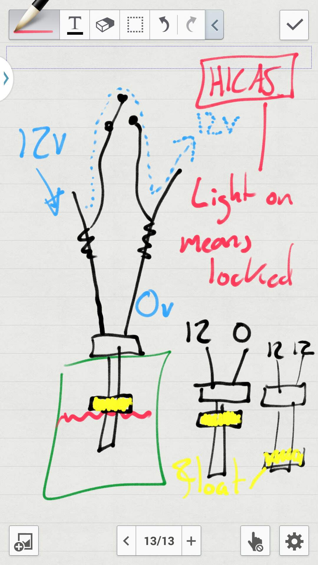

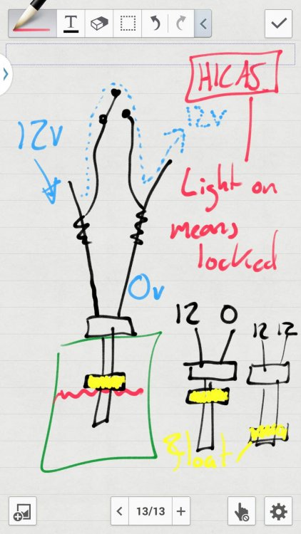

I have put a switch into the power steering reservoir fluid level circuit, and wired it into a rocker switch on the dash. I can turn my HICAS on and off from corner to corner. Wasn't hard to do, tell it it's run out of fluid and it locks the HICAS (so long as the suspension arms and bushes are still firm) you have a regular locked back end. I like HICAS for driving fast, for driving sideways I flick the switch and drifting is then in easy mode (easier).
That is absolute genius! Any chance of a quick guide as to which wires the switch connects to? :)
Haha it was Yowsers Idea. I made a meal of it but it wasn't complicated, I worked it out with a multimeter and sliding the float up and down.
I think all it took was bridging the 2 wires that go into/out of the pot with a massive loop going into the car. But it even lights up the HICAS light as if it was designed to be done :-)
Ill pm you some stuff on it in the next few days.
Stand by for a Tom Wilson wiring diagram lol!
Not exactly the front of a Haynes manual but its done on a phone! Think thats all it took.
Float down outputs 12v
