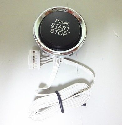

I have just installed the above into my Z and it's great! Am like a dog with 2 and possibly even 3 c***s
I just walk upto the car with the fob in my pocket and as I get within 2m of the car the doors unlock
When I get in the car if I put my foot on the brake the start button flashes green and when I press it the car starts, pressing again will stop it
If I'm just wanting to switch the acc on while in the car I just press the button once without touching brake and the button goes blue and acc is on. Press again and goes off
I then get out of the car and walk away, listening to the clunk of the locking as I shuffle more than 2m away from the car.
The fob has lock/unlock over ride buttons on it just in case and is also able to remote start the car... AWESOME!!

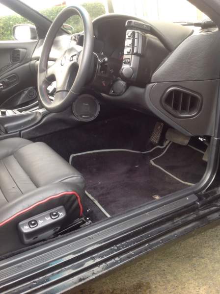

Thinking about it, what did you do about the steering lock ?
I installed it myself and there's quite a lot of work involved. I put my spare key in the ignition switch, turned it too first click to switch steering lock off and then snapped the spare in the barrel. The hole in the steering cowling has been totally blanked off and covered. There is no ignition loom connected to it now as this now goes to start/stop module that is firmly secured right up behind the dash were it is near impossible to get at without removing loads of stuff

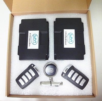

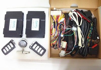

I can supply them. There unbranded but are as good a quality as any of the top brands in the UK. The wiring harness is probably the best quality I've ever seen.
I run the system as a full alarm system with microwave sensor and door/boot/bonnet protection but I can supply the start/stop module on its own without the RFID alarm for those who want to keep there own alarm/immobilser
How much to supply the start/stop module, I presume it comes with the smart start/stop button?
Yeah u get everything you need. £95 delivered inc vat

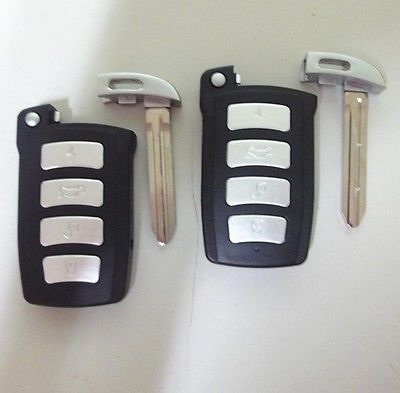

The same as what happens when the battery in a normal fob dies, you use the key to open the door.
Look at top pic
And its RFID PASSIVE so the lock/unlock doesnt run off a battery its like the transponder chip in your ignition key
